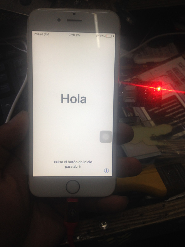

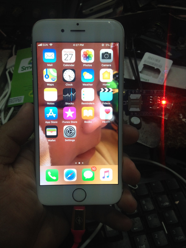

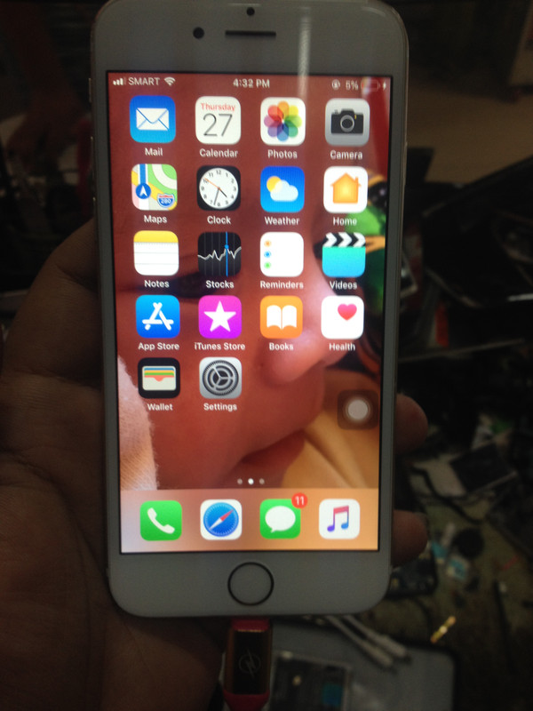

Share ko lang ip6 UNLOCK SIMI FU by.tester desk
yung una nalilito ako gamitin,same lang pala sila ng GPP na ginagamit natin....basta may ICCID success po mauunlock.
procedure
*5005*7672*00# or *5005*7672*ICCID#
sim one(white sim)
sim2 dahil nandun yung sim(smart,sun,globe) doon ko iniset
Done!!

yung iphone 6 nka ios10.3.2 lang.. pero ung 6plus na i-update ko ng 12.4 ehh.. how the procedure po para gumana? and what are needed po sir ?
boss ios12.3 or 12.4 need 3g sim or hanap ka ng hindi ios12.3up update mo iccid...may trick po dyan
