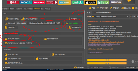

1st: open unlocktool
2nd; pwnd unit thru ipwnder
3rd: go to UT ramdisk menu
4rth: click ios15 5s 6s 7 7plus
5th: boot ramdisk
6th: back up passcode
7th: reset Using UT
8TH: pwnd unit thru ipwnder
9th: install back+ disable ota
pasinsya eto lang pics ko, feedback lang sa result
