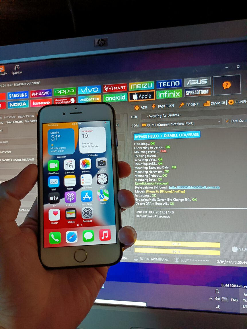

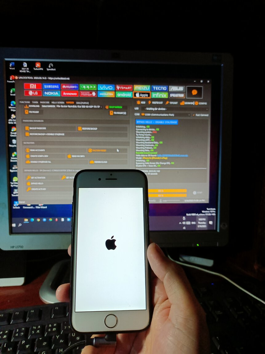

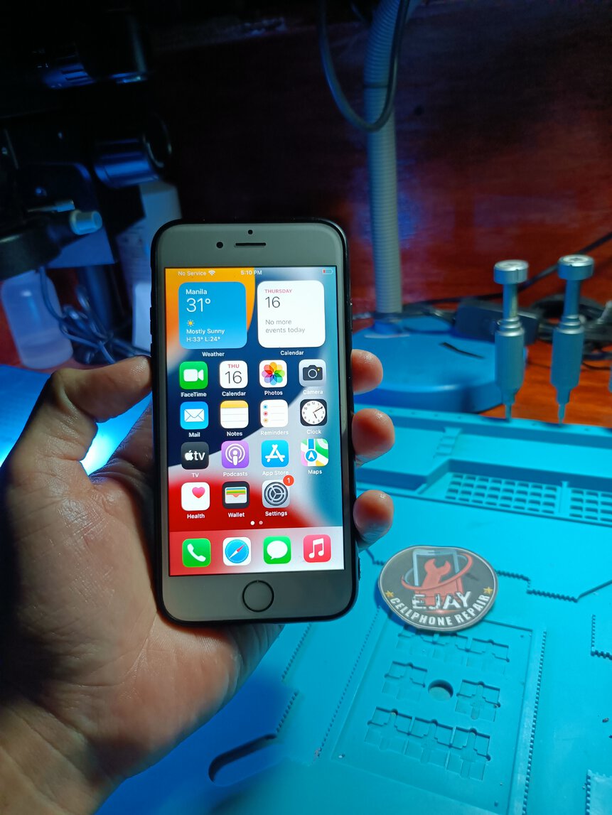

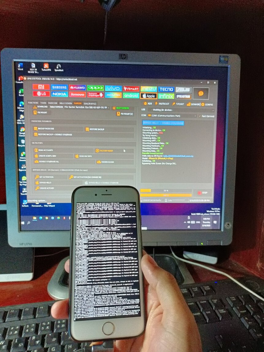

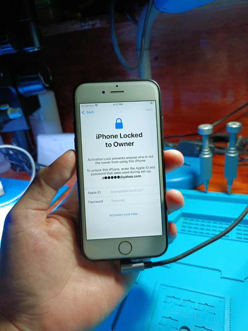

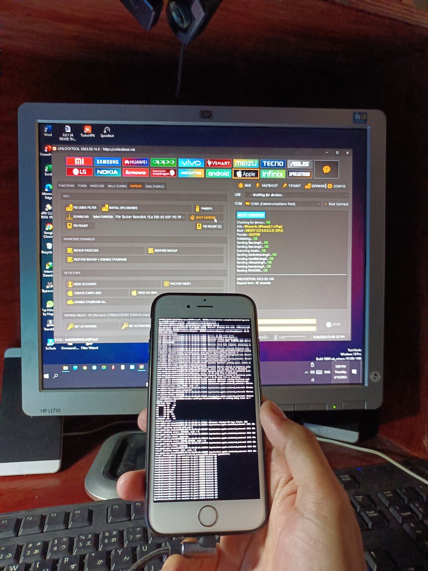

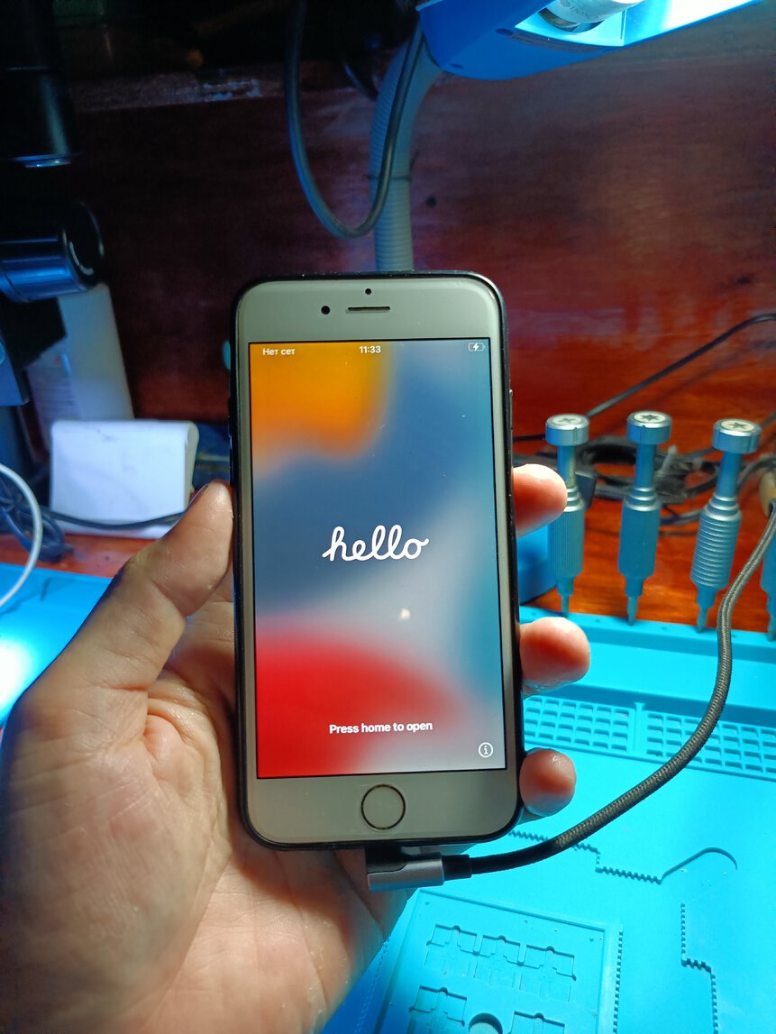

IPHONE 6S HELLO SCREEN BYPASS DONE ✅
❌NO NEED CHANGE SERIAL
❌NO NEED DCSD CABLE
ALL YOU NEED IS UNLOCKTOOL AND LIGHTNING CABLE
FIRST CONNECT IN NORMAL MODEL

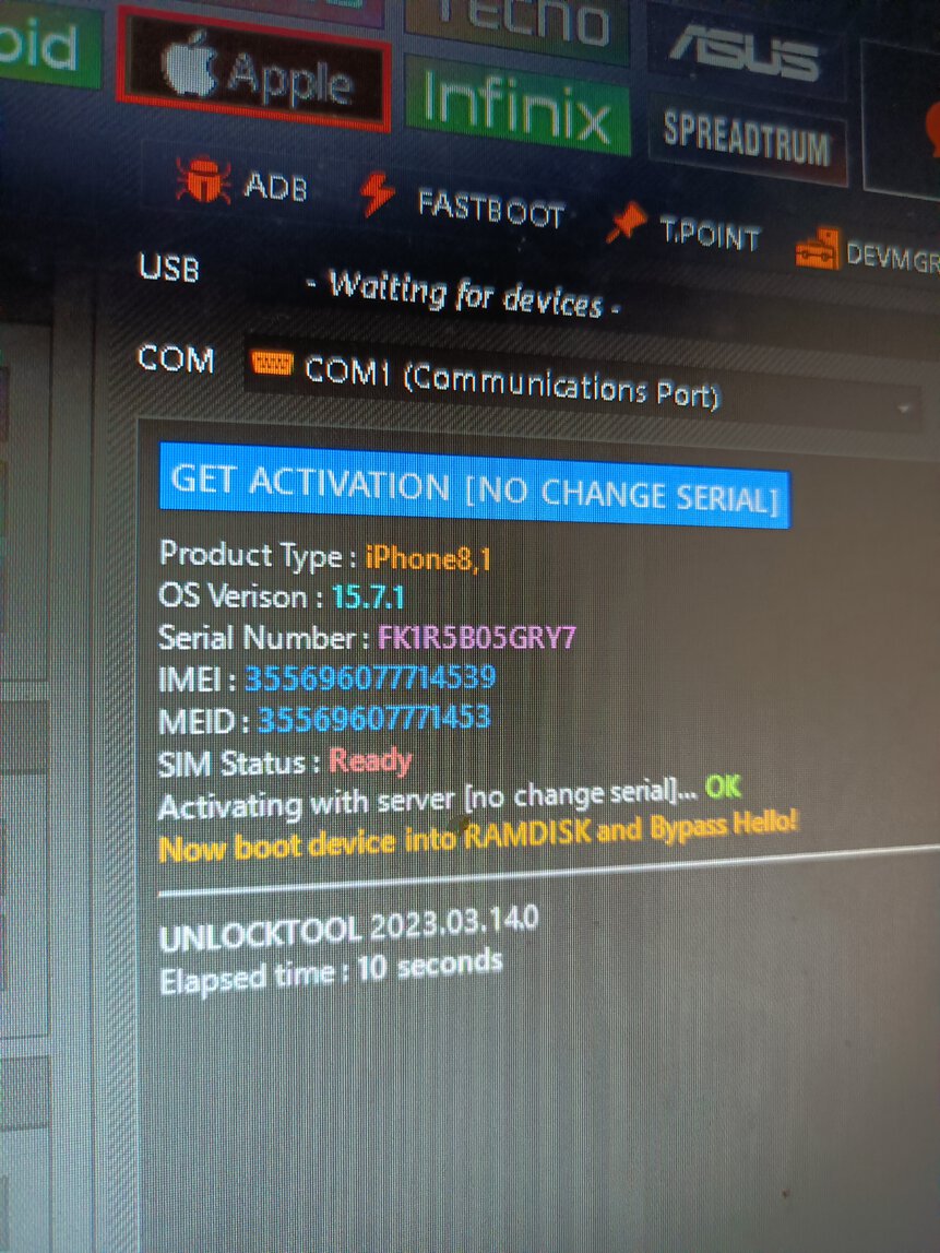

ON UNLOCKTOOL CLICK APPLE TAB
- CLICK RAMDISK
- LOOK FOR " GET ACTIVATION [NO CHANGE SN]
- AFTER SUCCESS
YOUR UNIT NEED TO DFU MODE
IF ALREADY DFU MODE

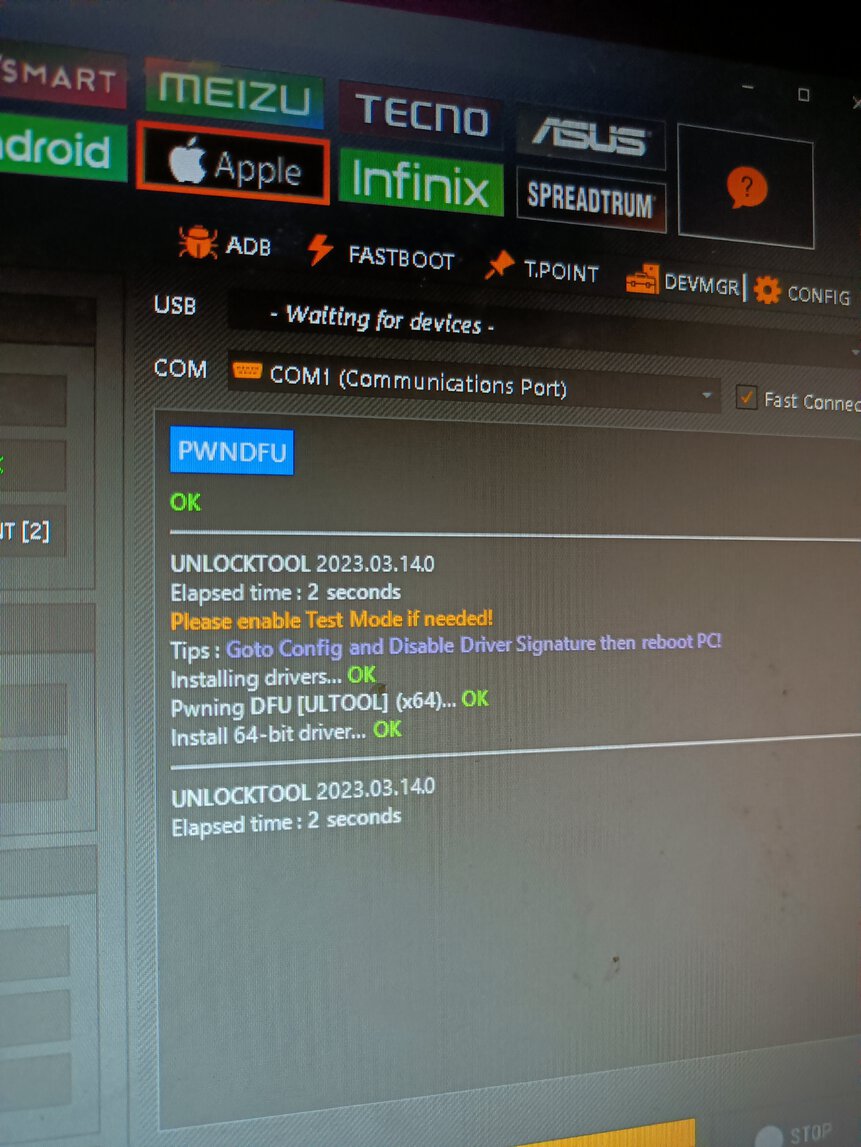

CLICK "PWNDFU"
AFTER SUCCESS NEED NIYO PO LOADER MARAMI PO TUTORIAL NYAN YUNG LOADER EH NASA UNLOCKTOOL WEBSITE PO
NOW :
BOOT RAMDISK
AND WAIT UNTIL SUCCESS
AFTER SUCCESS BOOTING IN RAMDISK
CLICK BYPASS HELLO + DISABLE OTA/ERASE
THEN CLICK NO CHANGE SERIAL
AFTER THAT WAIT UNTIL SUCCESS
- CLICK RAMDISK
- AFTER SUCCESS

CLICK "PWNDFU"
