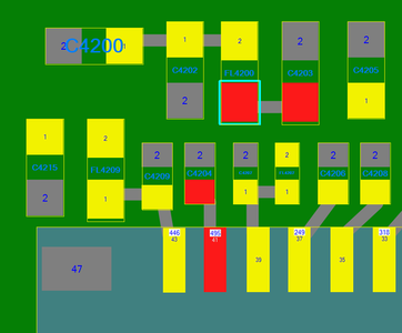

CHECK NYO MUNA KUNG GOOD ANG BOARD OR NAG POPOWER MUCH BETTER KUNG MAY PANG TEST KA LCD
TRACING VIA DIODE MODE SA FPC CONNECTOR KUNG SAN WALANG READING PIN 41 NO READING

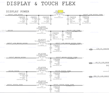

CHECK LANG COMPONENTS TAPOS SCHEMATIC READING LANG ANG SALARIN BUSTED COIL FL4200 HINDI NAKAKAPAG SUPPLY SA PIN 41 SA FPC CONNECTOR KAYA DI NAG DDISPLAY
DISCLAIMER: DI PO AKO EXPERT NAHULI LANG SA TIYAGA AT LAWAK NG PAG INTINDI

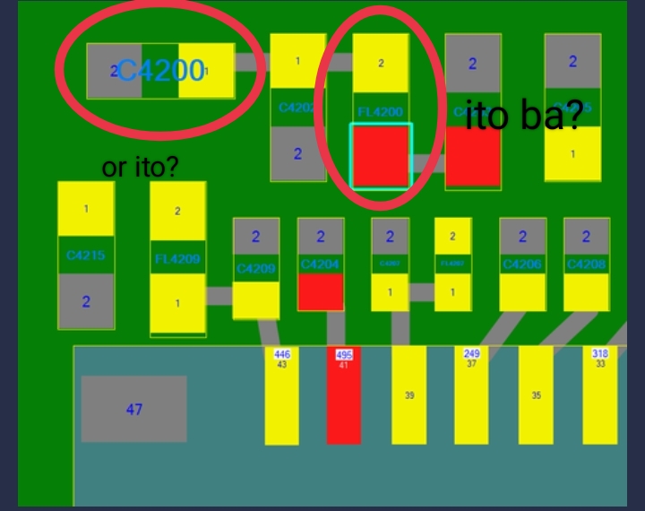

Correct ko lng po..FL4200 (coil) not capacitor po yung busted thats why wlang supply na dumadaloy...thaks for sharing sir edit ko nlng ung post para d malito ibang kasamahan natin.. :)
c4200 po ung short master di po ung fl4200
ano exact ginawa mo TS?
tinanggal mo po ba yung capacitor at pinalitan or di na?
