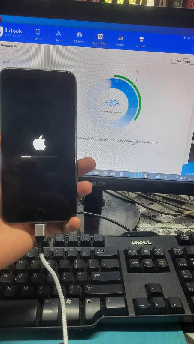

ito share ko lang itong nagawa ko na iPhone 6S Plus (A1687) na naka Hello screen
actually same procedure lang sya sa nagawa kong ipad mini 4.
ACTION:
step 1
- Fix Flash via 3utools IOS 15
step 2 - open Unlocktool
* Apple tab
* Ramdisk section
* connect iphone into normal mode,
* Download tab (after download)
* go to downloaded file and extract File Ramdisk and copy and paste to C:\UnlockTool\DataFiles\Apple
* back to unlocktool
* select RAMDISK
* install DFU drivers
* get activation no change sn
* pwndfu --> execute DFU mode. (connect data cable , hold power and home button)
* sunod boot ramdisk (hintayin matapos)
* isunod mo bypass hello
* no change sn (hintayin matapos...)
* done

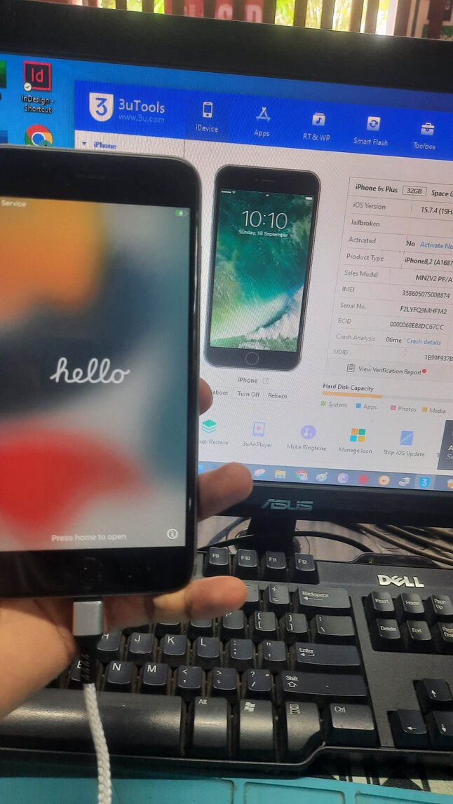

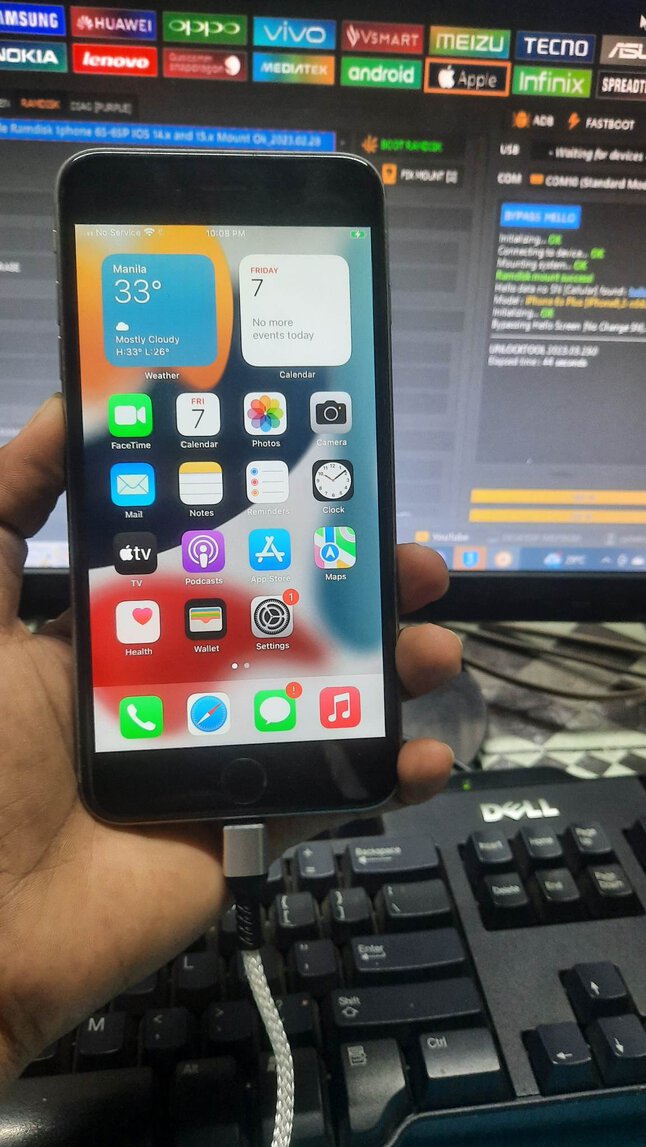

ito naman po ang patunay sa gawa ko.
pag pasensyahan nyo na kung medyo magulo dahil first time ko naka gawa ng apple mag bypass kaya medyo kabado at masaya dahil kaya ko pala. dina kilangan ipasa pa sa iba.
sana makatulong sa kagaya kong nag sisimula pa lang sa apple.
