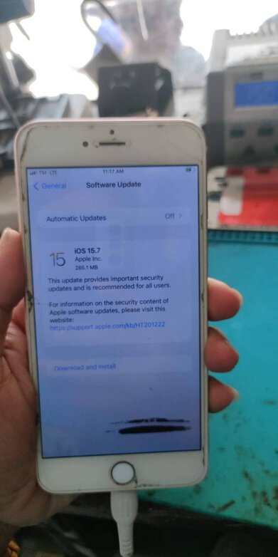

Iphone 6splus password Suprt model 6s to x

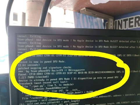

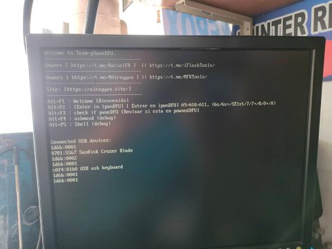

1)build usb checkm8 para sa pang windows pwndfu

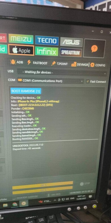

2)unlocktool boot ramdisk 1

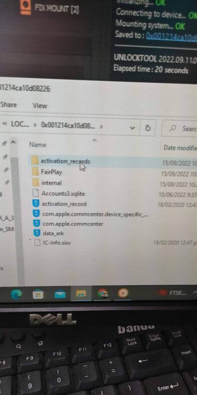

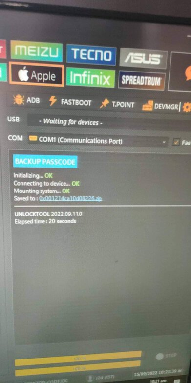

3)backup password
4)restore 3utools
5)pwndfu ulit
6)unlcokto ulit boot ramdisk 1
7)restore backup
8)activate unit done Sana maka tulong maga boss ko:) 306431170_763448574942840_6256678405413260546_n.jpg306551684_772843973944413_6310486204539838427_n.jpg306501343_621888402648423_7643674398497643721_n.jpg306314054_501488517977894_3473476873064827366_n.jpg306537623_424947936293160_2040130032292411798_n.jpg306526167_5546415032063269_2847392644734729614_n.jpg306645390_796845231647841_8117208594954205233_n.jpg
3)backup password

master ask lang po pwd rin bayan ganyang prucedure sa na reset na or na restored na e pwd bypass wifi use only na ganyan din ang gagamitin boss thanks sa sagot
sa paaword lang po yan sa na restore need palit serial irepair kung meron ka sir pwde yon pag meron aku ginawa post ko dito po :)
