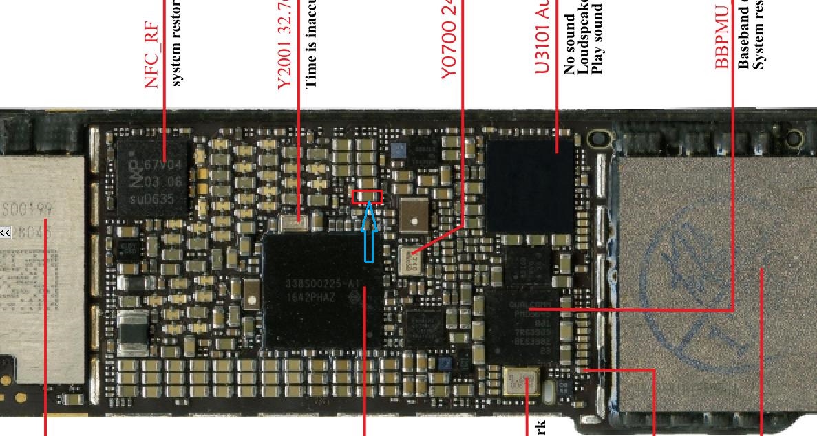

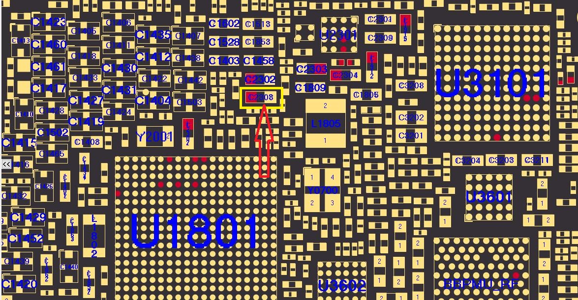

Unit Model:
iPhone 7 Plus
Issue:
No Power High Current
Solution:
Visual check muna kita na agad ang pwedeng salarin kaya nilinis ko lng muna pero high current pa din kya inisa isa ko ung caps na possible na sira at ang salarin is C2308 niremove ko lang at nawala ang high current and your done.
