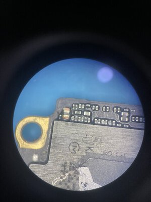

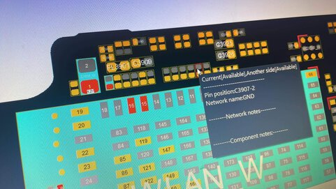

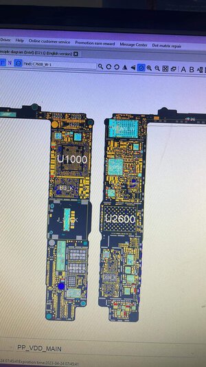

First step checking ako ng resistance from battery terminal at nakita kong sukat full shorted so take ako ng short killer para malaman kung saan nag short nakita ko short sa banda wifi ic capacitor

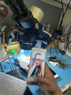

Inalis ko yung capacitor then check agad ng resistance and nag normal reading it means buhay na yung unit
Palitan lang capacitor all done
