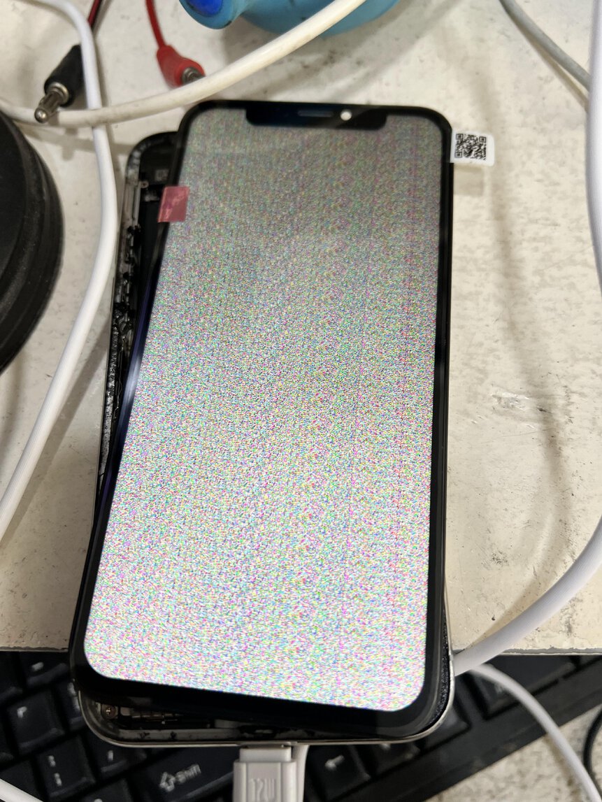

iPhone X Garbled display
1st step: Mag test ng new LCD or known working
pag same pa din Huwag ka mag ha-hardware repair

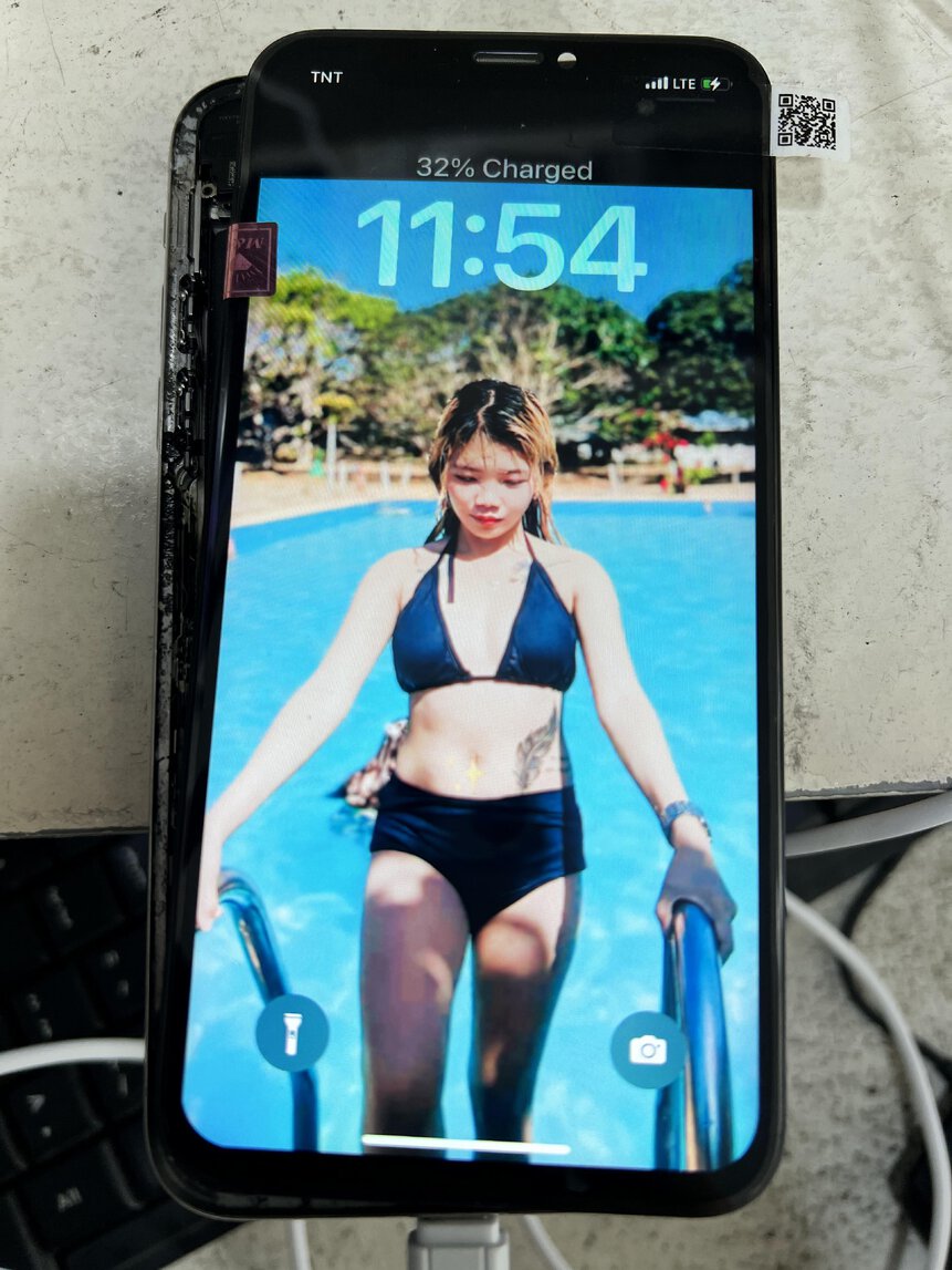

2nd step: SOFTWARE
sa case na ito after 3utools retain flashing
na fix ang problem
Done
2nd step: SOFTWARE
na fix ang problem
Done
