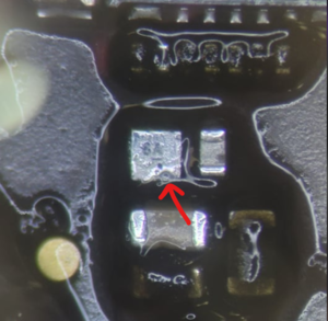

Stuck in DFU mode
Flashes successfully with an update or restore but goes back to DFU mode.
Symptoms:
  • Screen shows no image and pulls 0.45A via USB charging
  • Does not appear to boot
  • Prompt to boot on DCPS, shows it hangs around 45mA draw
  • Connect to PC and it's in DFU mode
  • Flash an update or restore & it goes through 100% with no errors but goes back to DFU mode
Solution:
  • Check R0601 at the corner of NAND.
  • This resistor connects PP1V8_IO to SPI_AP_TO_S4E_MOSI_BOOT_CONFIG1
  • Clean the underfill around it & poke it hard.
  • If it breaks, it must be replaced.
  • Value is 4.7ohms
  • After replacing it, the phone will no longer be in DFU mode & boot right up.

Take notice of the orientation dot
