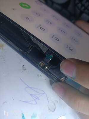

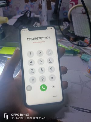

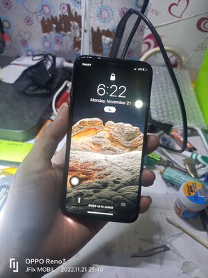

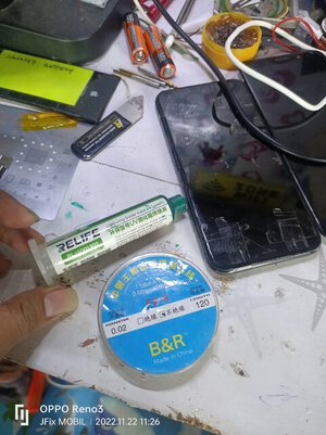

IPHONE X NO DISPLAY PAG BUKAS KO PUTOL NA PALA KASI NA HULOG DAW....

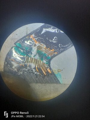

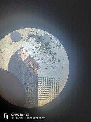

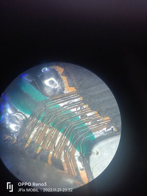

GANYAN LANG GINAWA KO PARA MAG KA IDEA KAYO NA PWEDE PANG GAMITIN AT MAA AYOS..... BASTA HINDI BASAG ANG SCREEN OR LCD..
PARA MAKA JUMPER ITO KAILANGAN MO..
1. Jumper wire 0.02.
2. Green mask.
3. Uv Light.
At kailangan dika kabado at my anger issue HAHAHa Madali din ako ma inis noon piro now madali na saakin mag jumper
PA LIKES PO THAANKK YOUU.....
