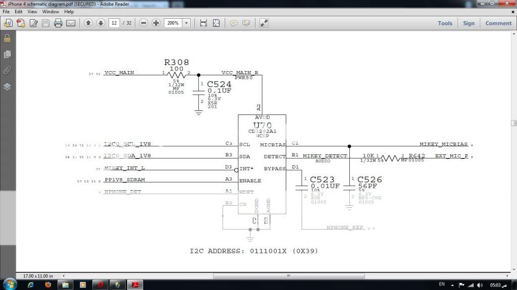

Eto naman ang sunod na pinalitan ko, at eto na rin ang salarin kung bakit
walang sound output sa headset,. pinalitan ko po ung U70
Eto po yung pinagbasihan ko..

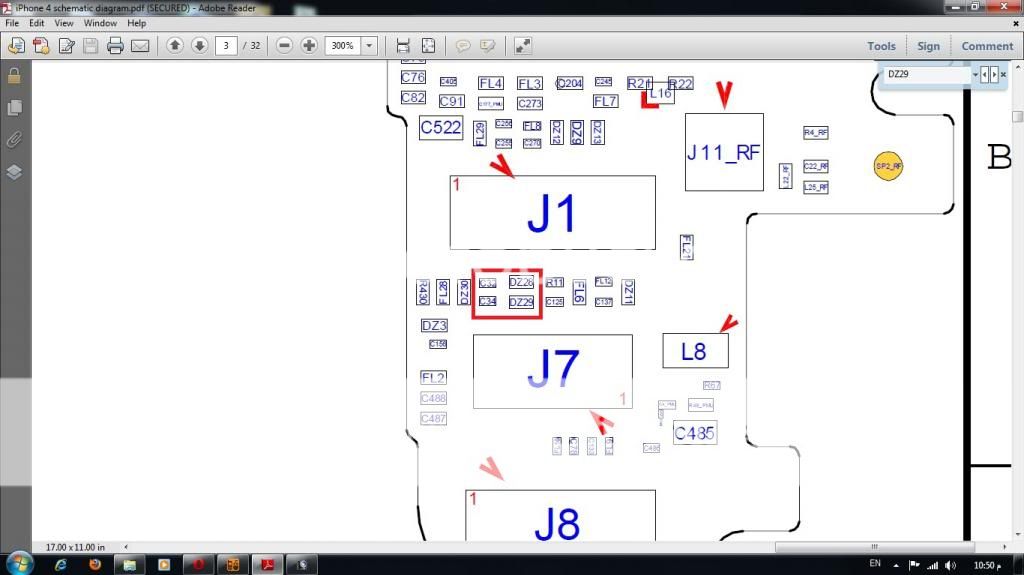

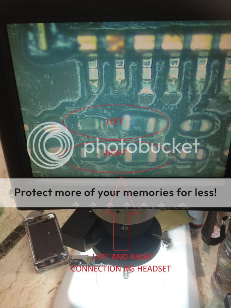

Kaya tingin ako agad sa aking mahiwagang diagram ng conection. isa isa kung pinalitan
yung C32,DZ28,FL26 left connection at C34,DZ29,FL27 right connection,check ko din yung line
pero ganun pa din

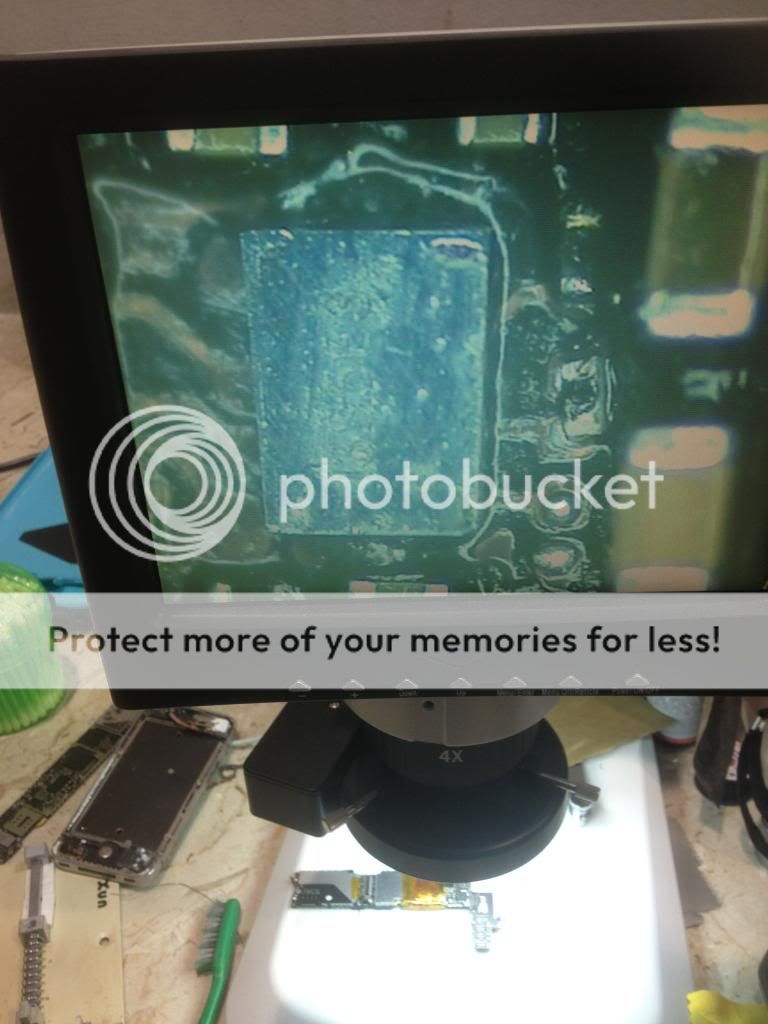

| This image has been resized. Click this bar to view the full image. The original image is sized 1024x575. |
| This image has been resized. Click this bar to view the full image. The original image is sized 768x1024. |

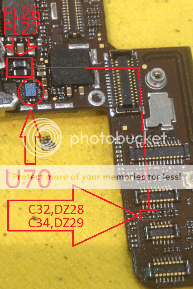

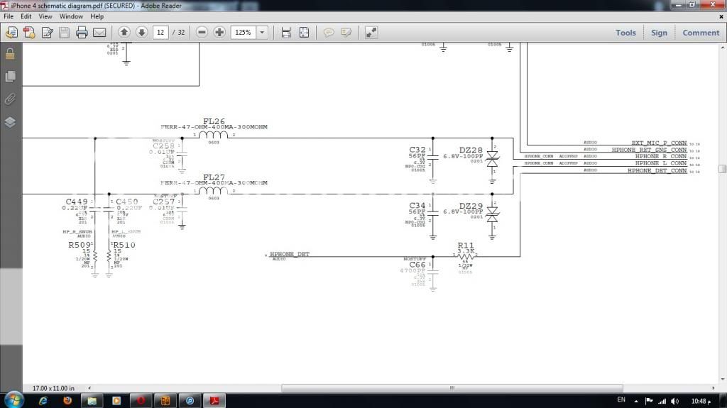

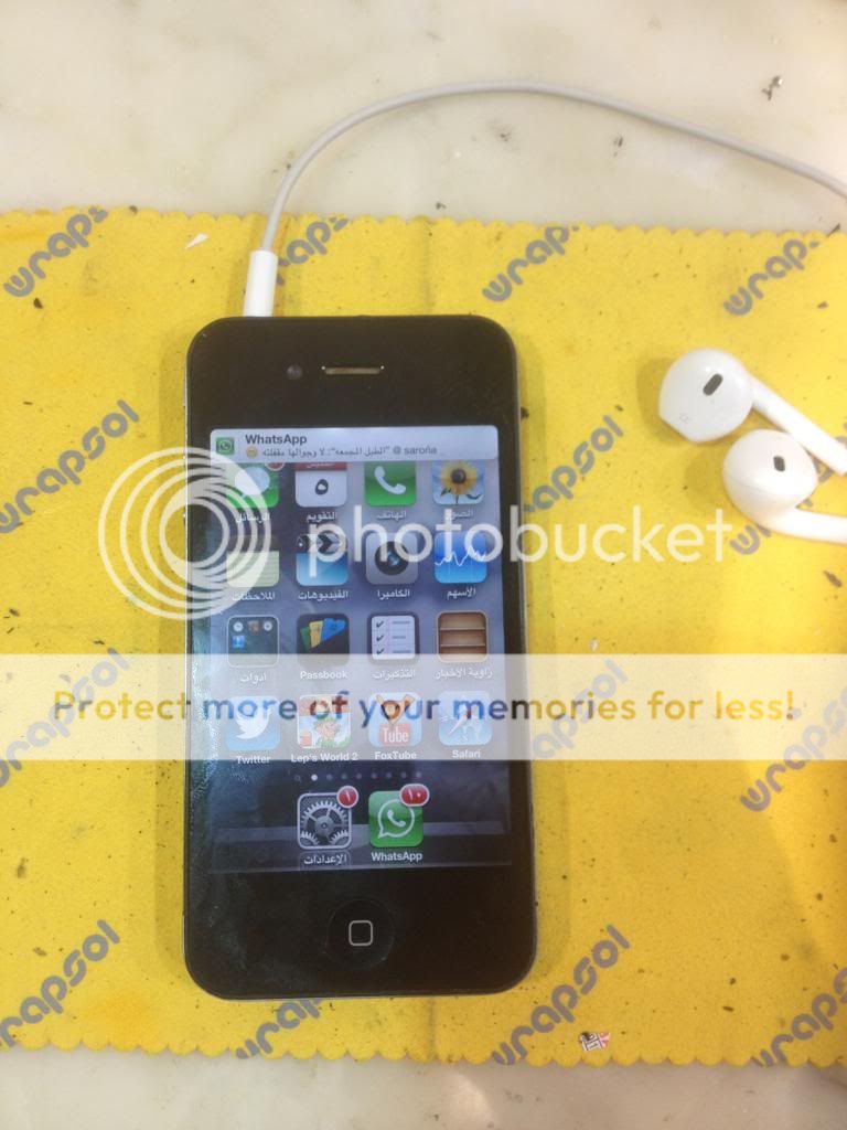

DONE
