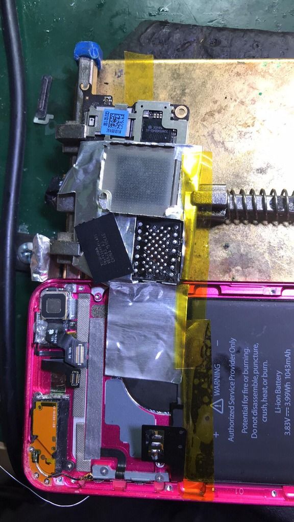

proceed agad Dismantle Unit Gamitin si Youtube para safe ang pag baklas Search.
target Remove Nand.
Ingat lang sobrang nipis ng Board ni ipod Touch .

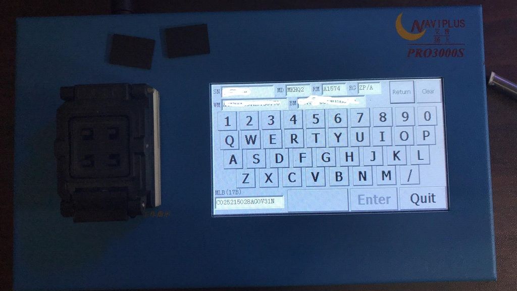

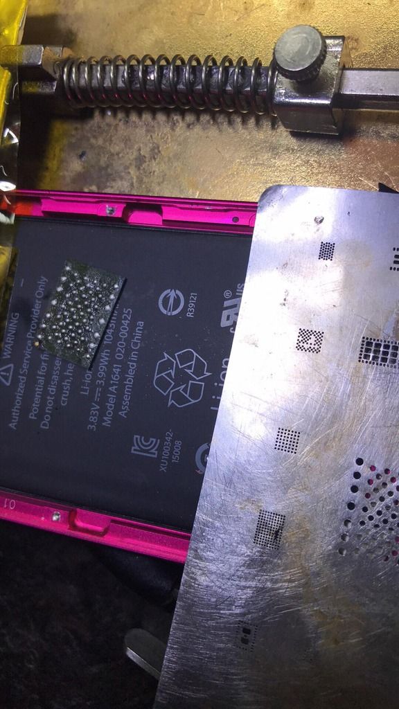

Reballs na ready for edit serial.
Now write fresh serial A8 same serial sila ng air2 64Bit Pm nyo mga suking tindahan nyo for fresh serial.

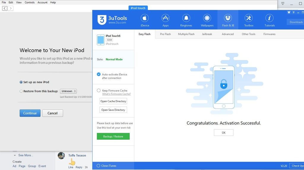

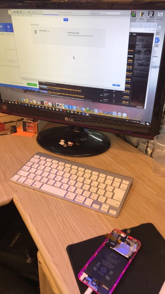

Next ready for restore.... dikuna nakuhanan ng picture after edit ko veryfying lang always..ginawa ko back up nand after back up format hdd then write boot iphone6 after write boot write back up ayun pasok.
after restore..activation pasok.
target Remove Nand.
