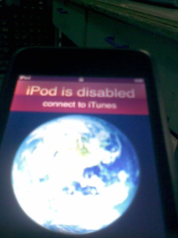

Ito po picture bago ko inayos:
Action taken Bago ko inayos:
**Connect ko po sa Computer ayaw maDetect

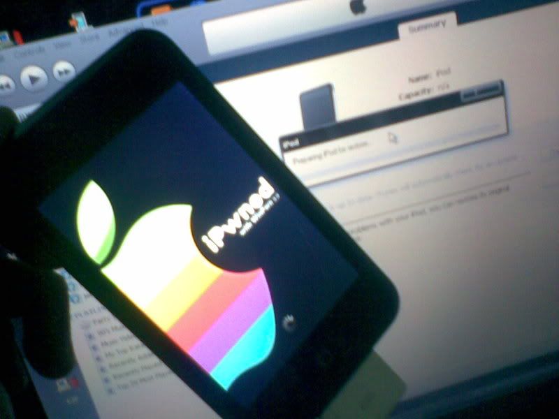

1. Open niyo po ang Itune
2. Made your IPOD Touch Recovery Mode... ganito po
Press and hold the Home button and the Sleep/Wake button at the same time
Hanggang Lumabas po ganito sa Itune

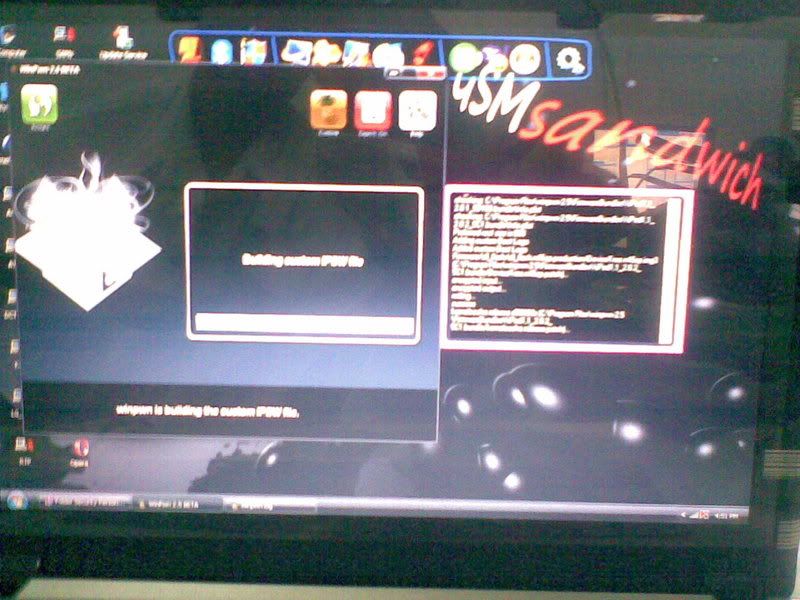

3. Open Niyo po Winpwn at Click niyo po ang IPOD TOUCH picture

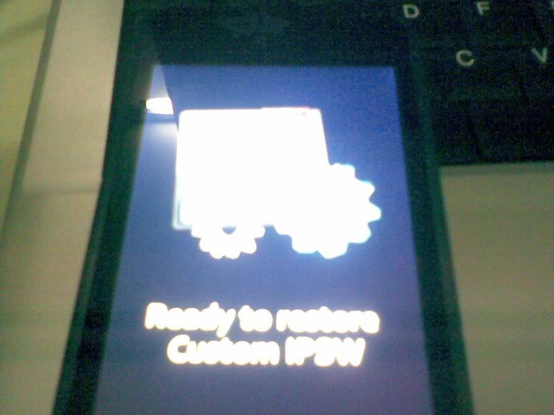

4. Disconnect niyo lang po sa computer ang IPOD Touch at Ioff niyo ang ipod at iconnect ulit sa computer..
5.
6. Open Itune tapos Hold SHIFT and Click RESTORE... Click niyo po ang Custom-Ipod1,1_2.0.2.5C1_Restore.ipsw...
7. Hintay hanggang matapos Loding...

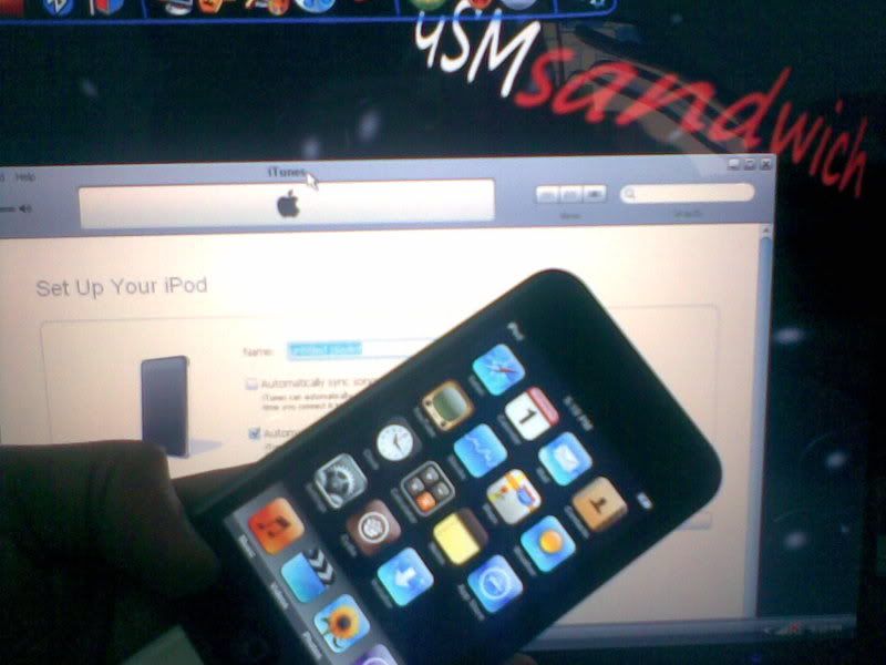

8. At ito na po Finish Product with the higher version .::2.0.2 (5C1):..
