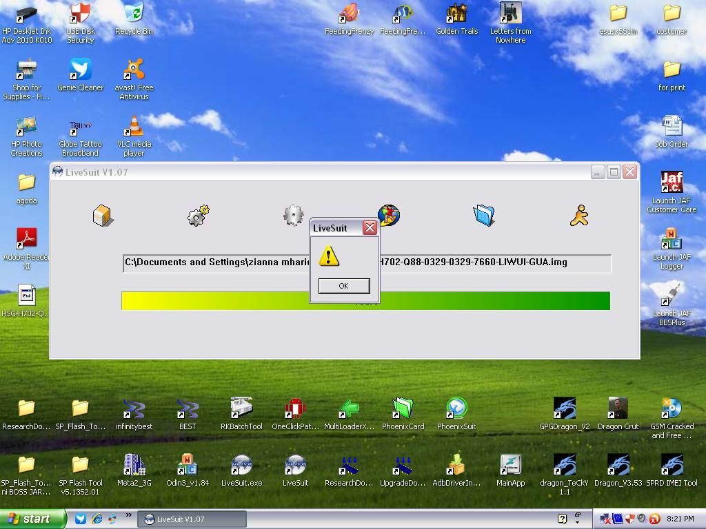

MODEL: ITECHIE 8G
BOARD ID: HSG_H702_V1.2
PROBLEM: PAG ON AFTER 10 SEC. BLUE SCREEN

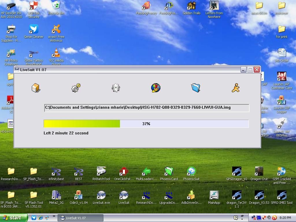

SOLUTION: FLASH USING LIVESUITE
WARNING: PAKI SABI LANG KAI TOMER NA NOT WORKING UNG CAM. IF OK LANG BA SAKANYA PARA WALANG BACK JOB.

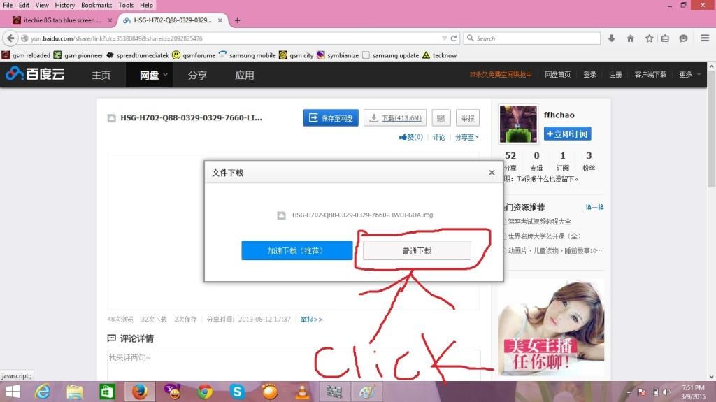

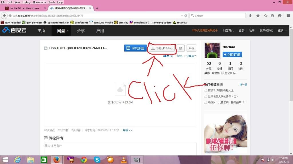

FIRMWARE: HSG-H702-Q88-0329-0329-7660-LIWUI-GUA.img_å…Â费高速下载|百度云 网盘-分享æ— é™Â制
PAKI FOLOW LANG SCREENSHOT PARA SA PAG DL NG FW
SORRY DI KO NALAGAY SCREENSHOT NG PROB. KAC BACKLIGHT LANG UNG NAKIKITA WALANG DISPLAY
ITO SCREENSHOT SA LIVESUITE

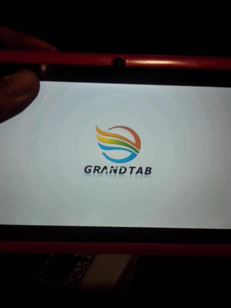

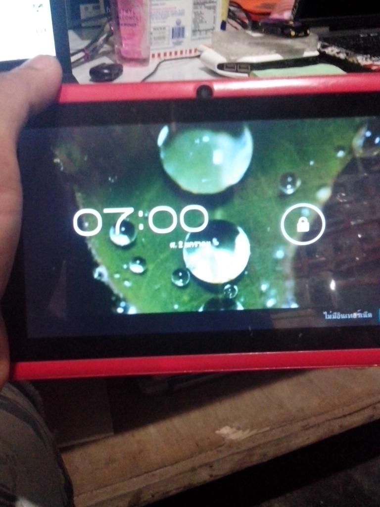

AT ITO FINISH PRODUCT
DONE

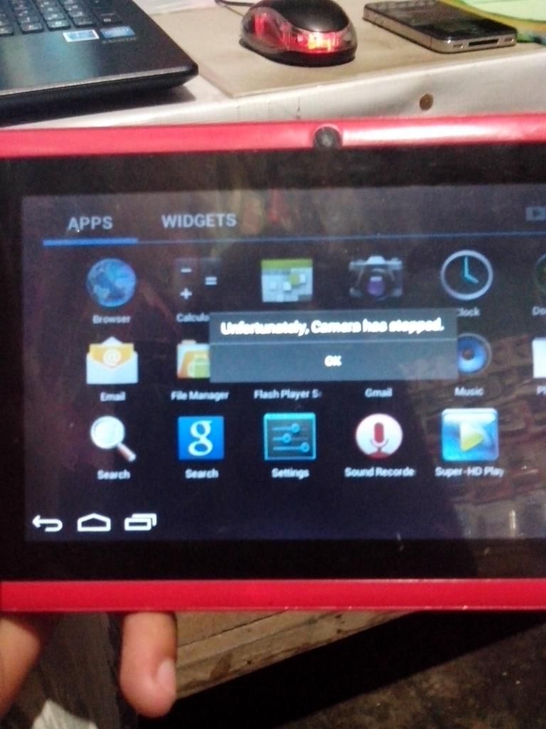

note di po gumagana ung cam
SANA MAKA TULONG[/QUOTE]
