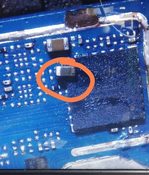

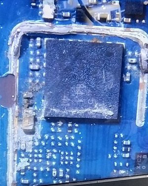

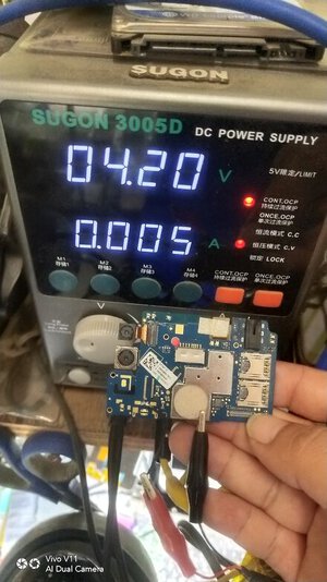

activa2r Administrator Staff member Joined Oct 30, 2022 Messages 714 Reaction score 2,665 Points 241 Location Leganes , Iloilo Feb 16, 2023 #1 visual check at yun nga may bakas ng basa... try linis .. may leak pa rin kaya change capasitor (supply to 2G PA) kuha na lang sa scrap board also from 2g PA para same 3.7v And Done..
