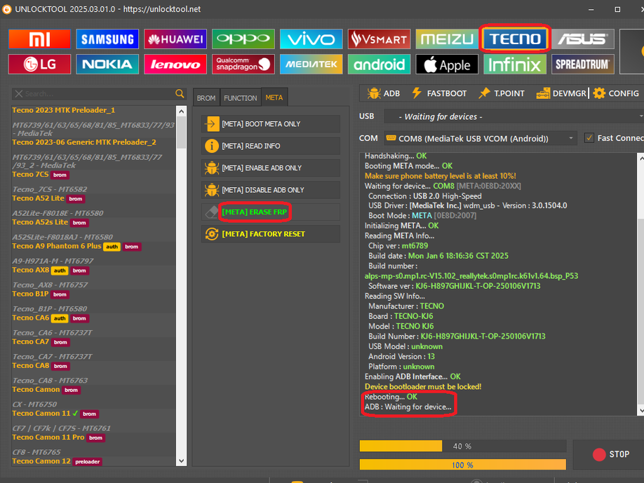

Another Meta frp no need select model remove by Unlock Tool

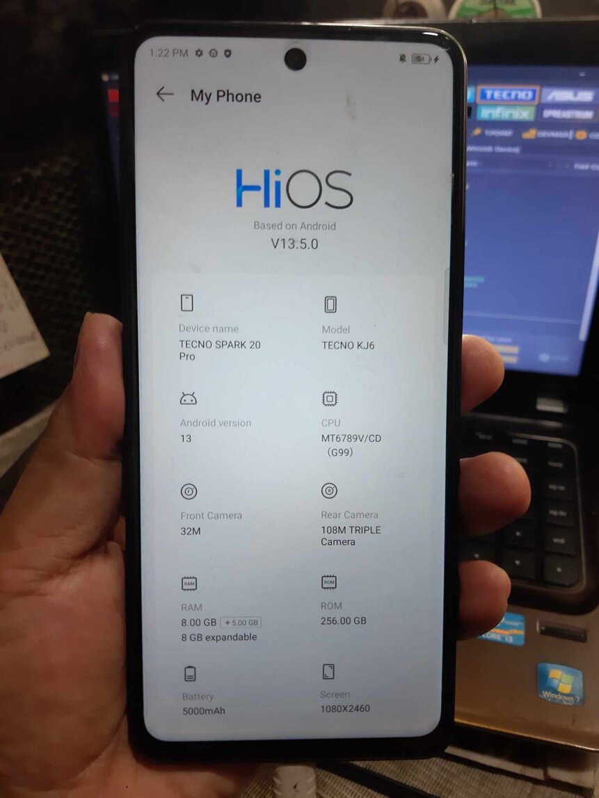

Device Name: Spark 20 pro
Model Name: Tecno KJ6
Boot Key: Volume up&down
Tecno Tab: Meta Erase frp done
see picture below..

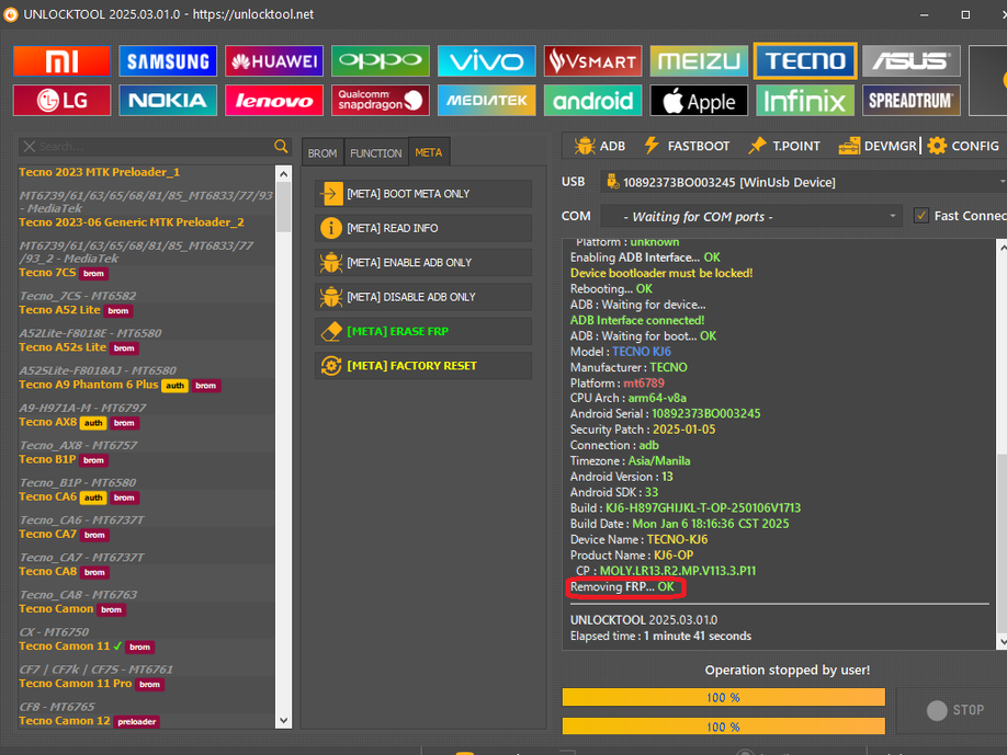

logs
[META] ERASE FRP Make sure phone battery level is at least 10%!
Waiting for device... COM7 [PRELOADER:0E8D:2000]
Connection : USB 2.0 High-Speed
USB Driver : [MediaTek Inc.] wdm_usb - Version : 3.0.1504.0
Boot Mode : PRELOADER [0E8D:2000]
Handshaking... OK
Booting META mode... OK
Waiting for device... COM8 [META:0E8D:20XX]
Boot Mode : META [0E8D:2007]
Initializing META... OK
Reading META Info...
Chip ver : mt6789
Build date : Mon Jan 6 18:16:36 CST 2025
Build number : alps-mp-s0.mp1.rc-V15.102_reallytek.s0mp1rc.k61v1.64.bsp_P53
Software ver : KJ6-H897GHIJKL-T-OP-250106V1713
Reading SW Info...
Manufacturer : TECNO
Board : TECNO-KJ6
Model : TECNO KJ6
Build Number : KJ6-H897GHIJKL-T-OP-250106V1713
USB Model : unknown
Android Version : 13
Platform : unknown
Enabling ADB Interface... OK
Device bootloader must be locked!
Rebooting... OK
ADB : Waiting for device...
ADB Interface connected!
ADB : Waiting for boot... OK
Model : TECNO KJ6
Platform : mt6789
CPU Arch : arm64-v8a
Android Serial : 10892373BO003245
Security Patch : 2025-01-05
Connection : adb
Timezone : Asia/Manila
Android SDK : 33
Build : KJ6-H897GHIJKL-T-OP-250106V1713
Build Date : Mon Jan 6 18:16:36 CST 2025
Device Name : TECNO-KJ6
Product Name : KJ6-OP
CP : MOLY.LR13.R2.MP.V113.3.P11
Removing FRP... OK
UNLOCKTOOL 2025.03.01.0
Elapsed time : 1 minute 41 seconds

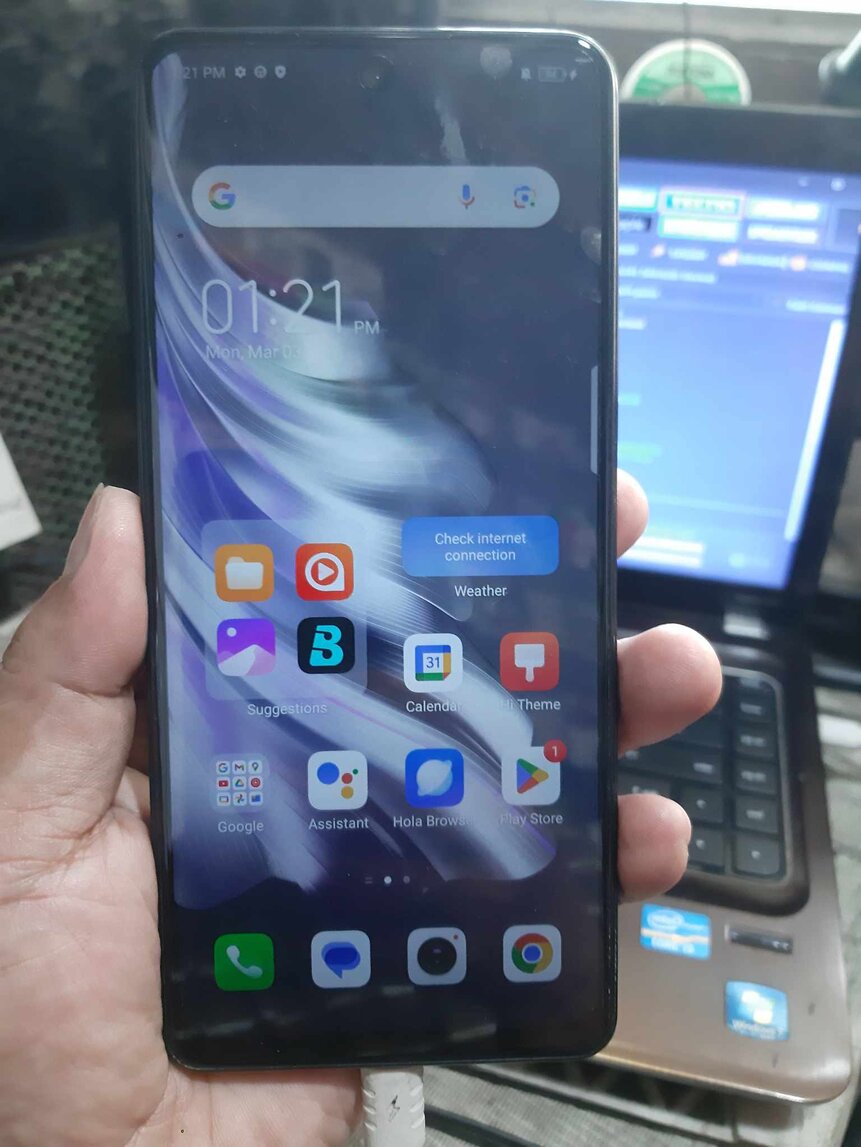

done
