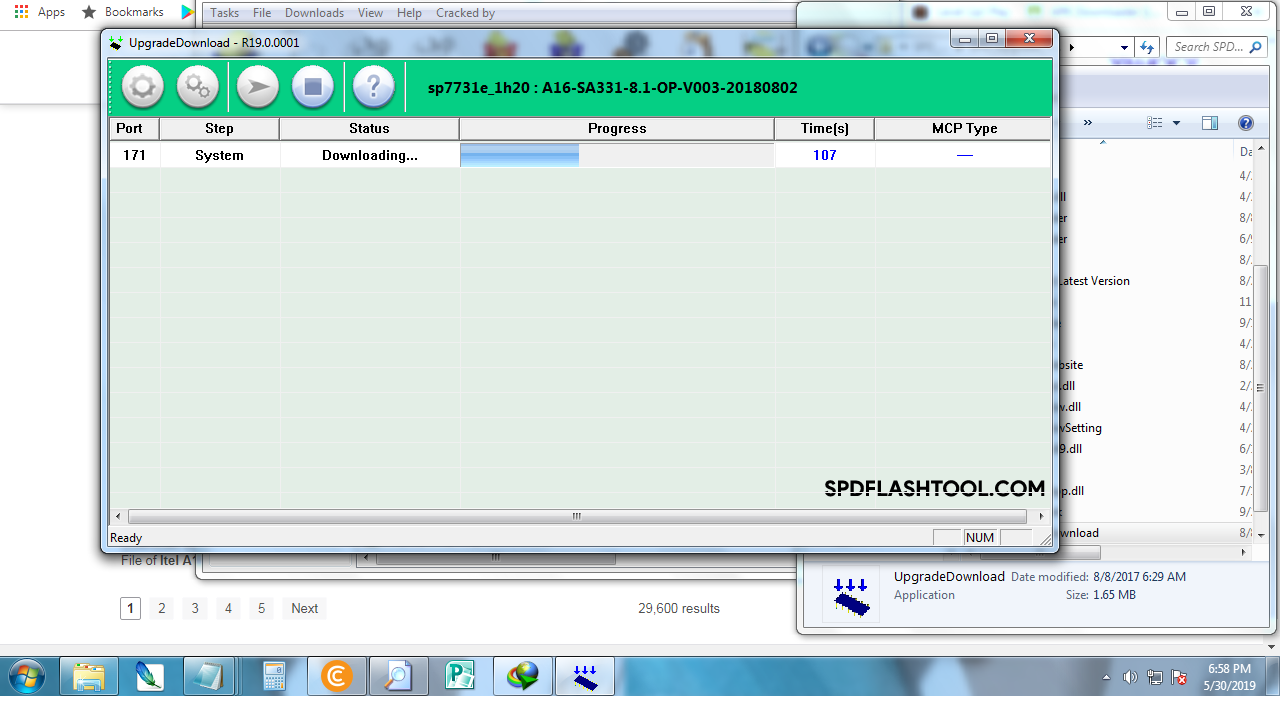

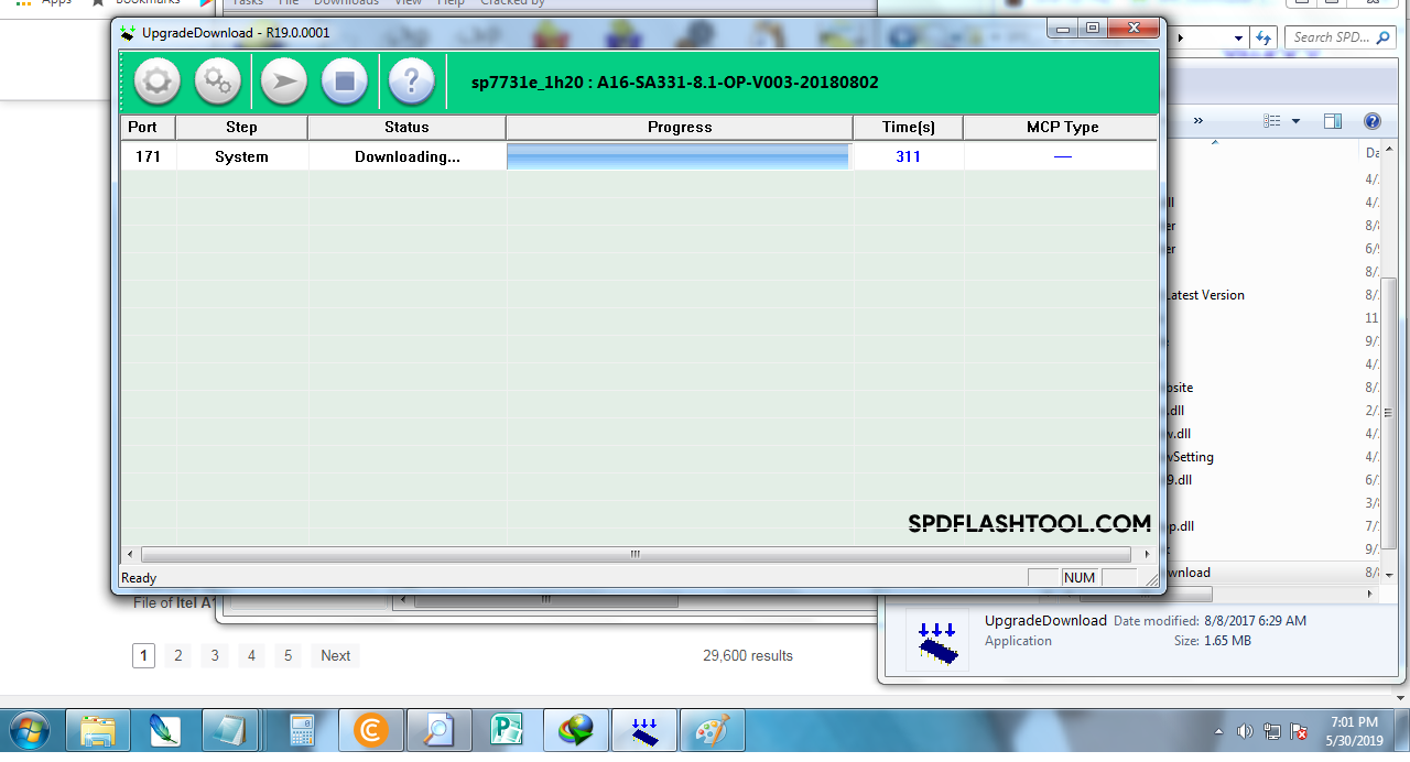

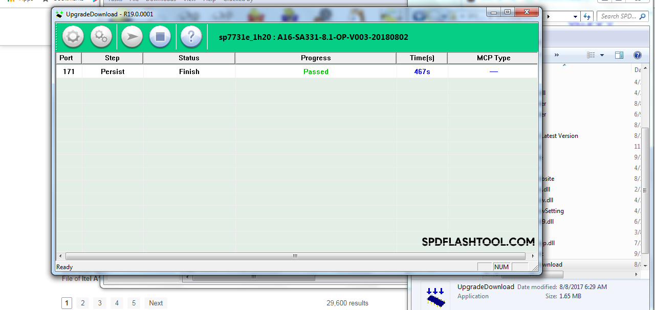

share ko lang po itong gawa ko Itel_A16 dinala sakin pag buhay mo lalabas ang logo tas diretso na sa fastboot...
hanap ako sa tahanan pero wala na nakagawa, kaya hanap agad ako firmware at di naman ako binigo ni kumpareng G stockroom ang binigay sakin
stockroom intel A16 SPD
Step 1. Download Flash File | Firmware | Stock ROM
Step 2. Download / Winrar/Spd Research Download Tool/Usb Driver
Step 3. Unpack ROM And Extract File.Pac
Step 4. Run ResearchDownload Or FactoryDownload.
Step 5. Click on “Load Packet” And Add The .Pac.
Step 6. Click On “Start”
Step 7. Connect Your Android Device To The Computer.
Step 8. During The Flashing Your Mobile Will Restart Automatically.
Step 9. Finish…
done ...
