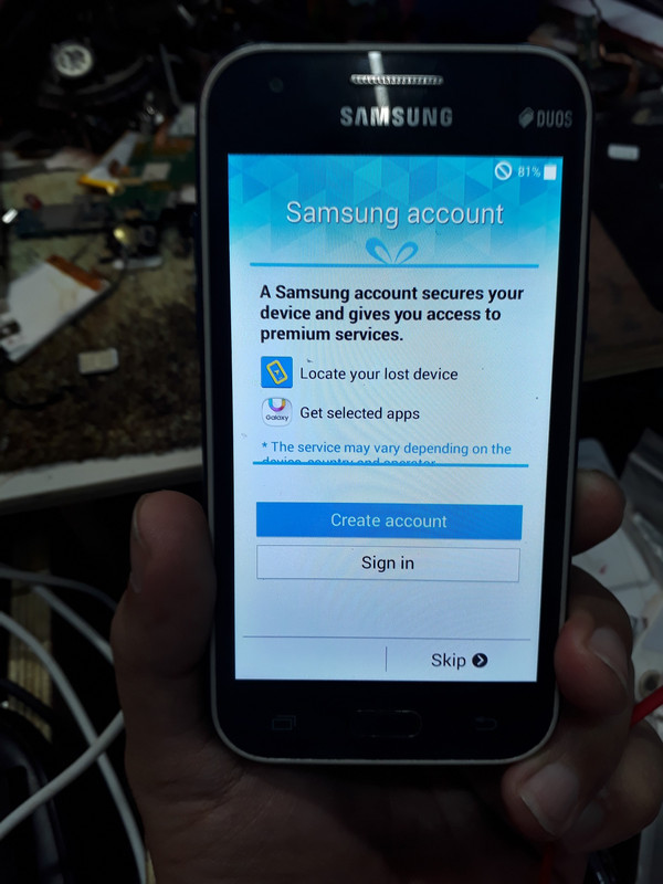

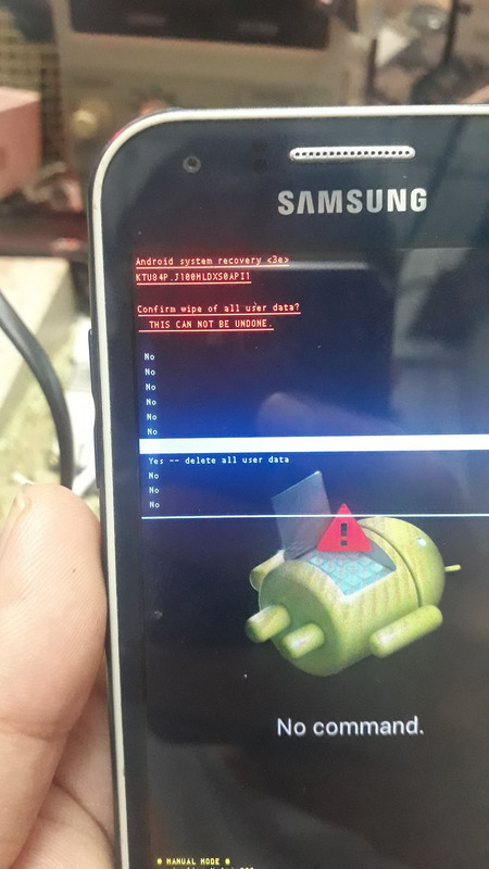

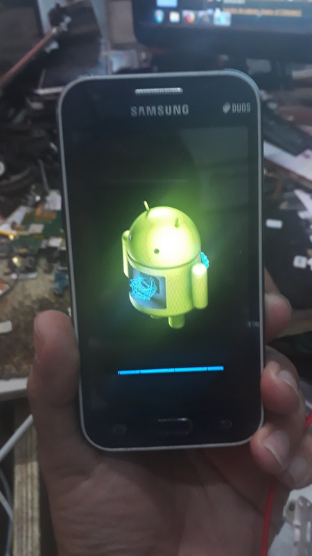

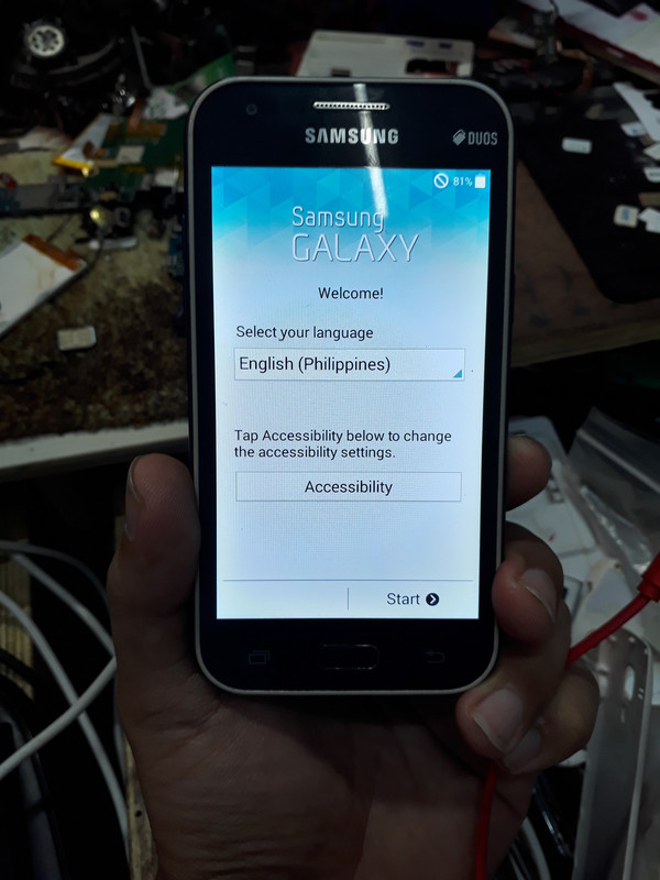

Share ko lang J100ML LOGO lang siya nung dinala sa akin......

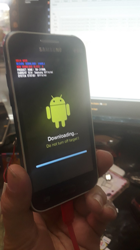

para makuha ang tamang firmware BOOT RESET(HB+VUP+P)
procedure

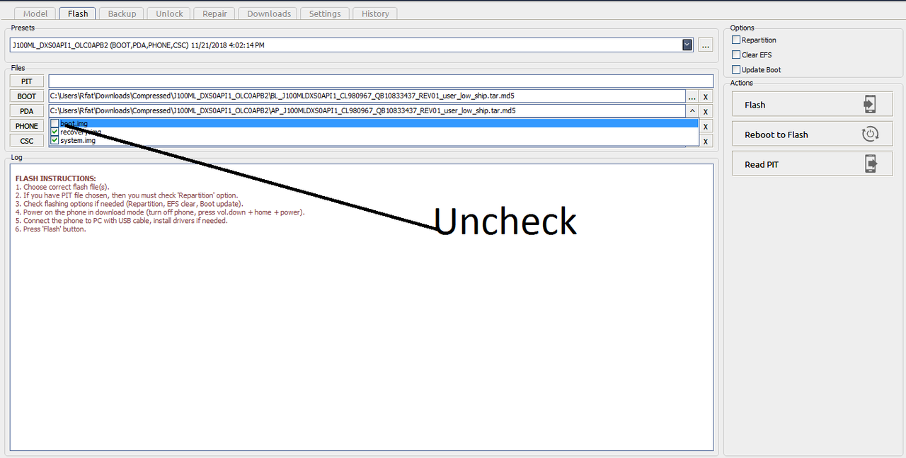

open z3x
model-j100ml/ds
DL firmware
Hold HOME+VOL. Down+Power
Uncheck BOOT.IMG(iwas deadboot)

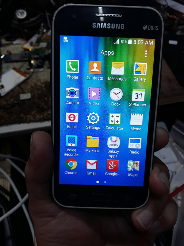

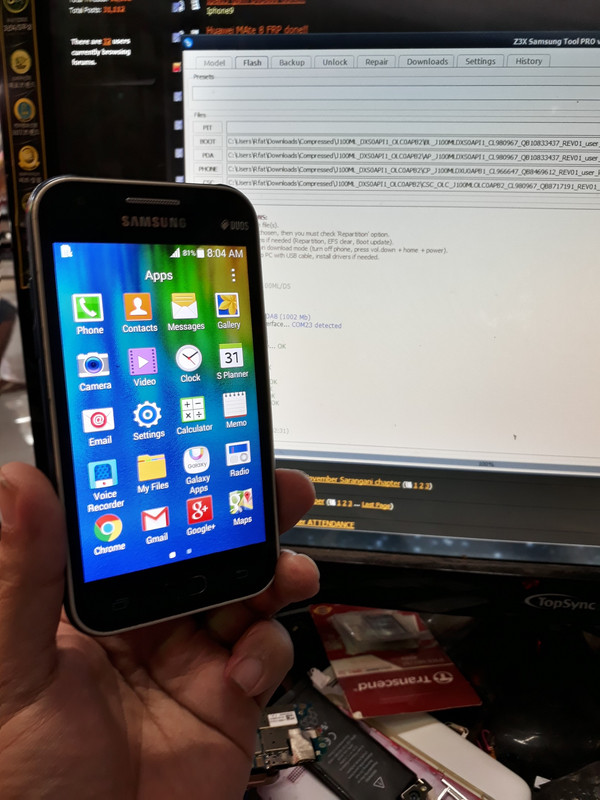

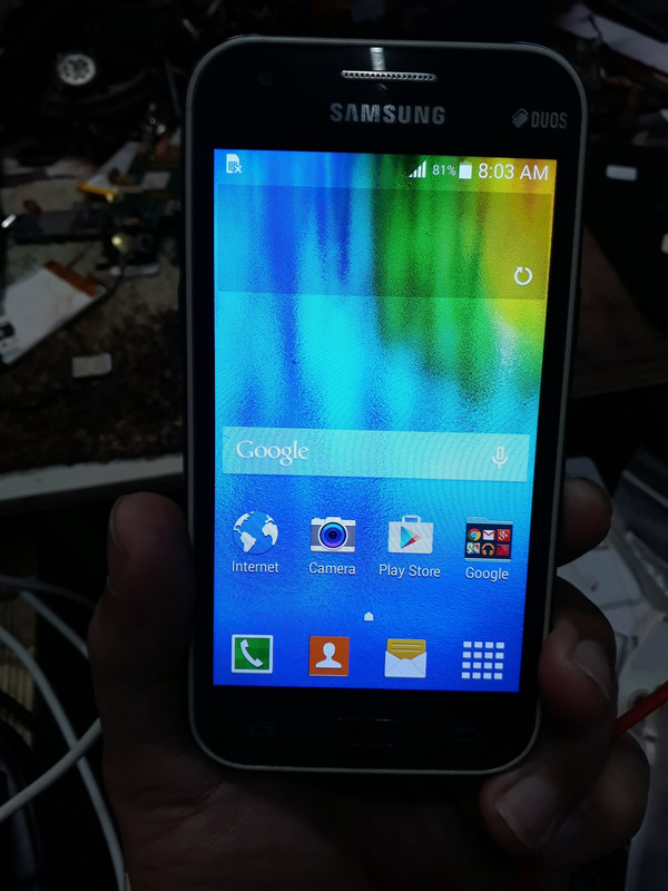

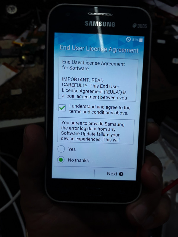

done!!
