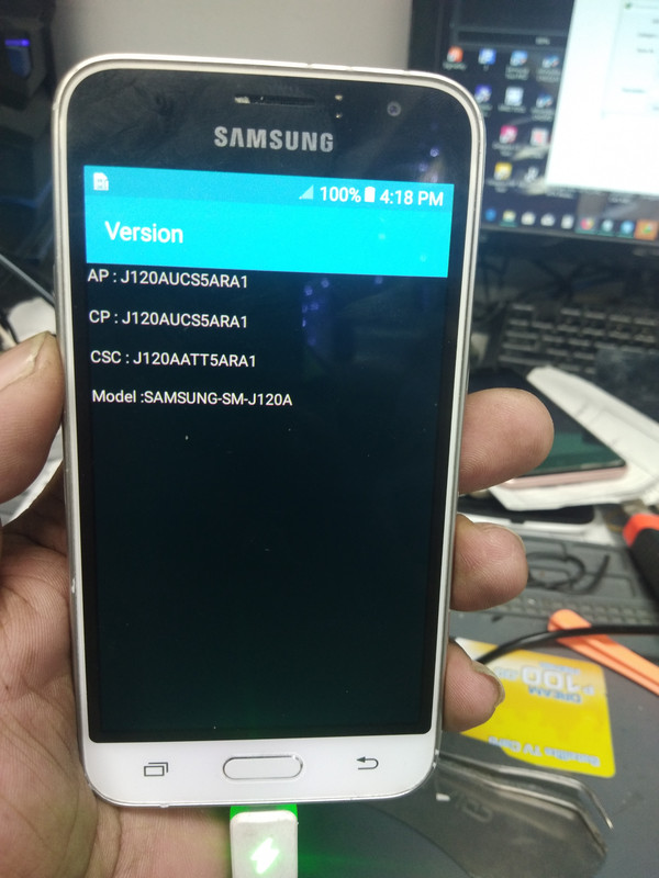

software version of the unit

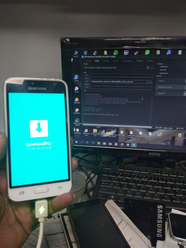

flash the unit using the file pero using z3x put in pda tab...
upload images
eto flash complete

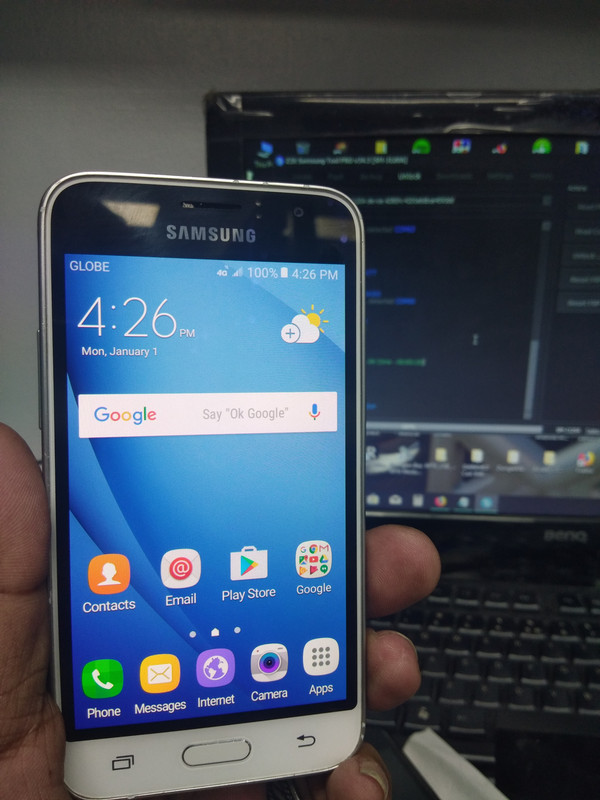

eto na finish product..

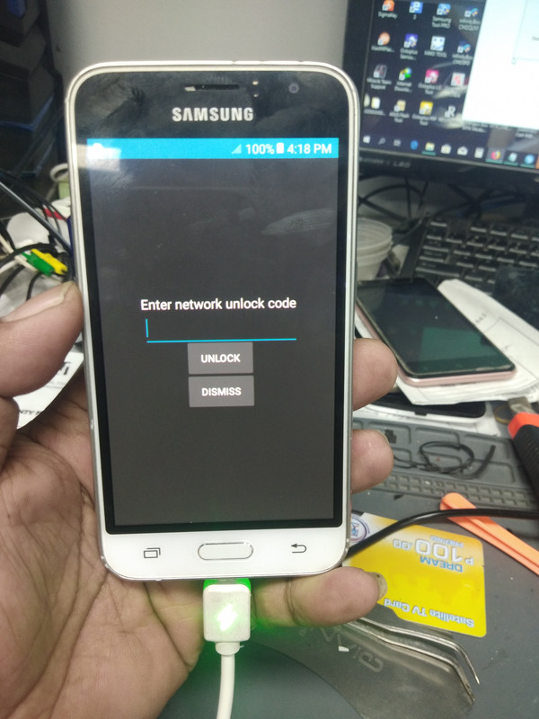

unit j120a
problem activate or unlock

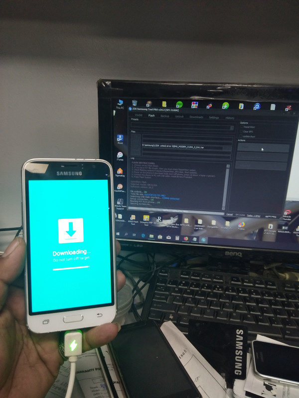

upload imageseto flash complete

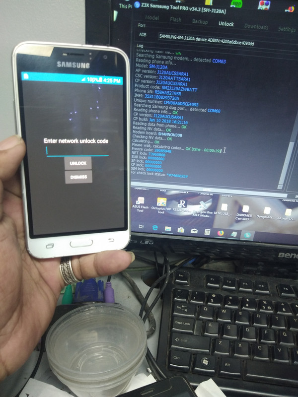

antayin mag boot ng maayos ang unit then read codes via diag sa z3x codes
