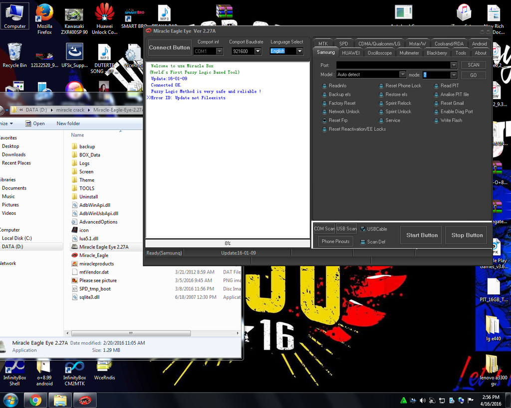

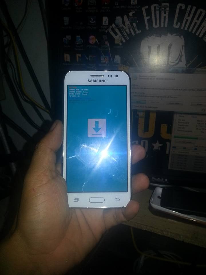

SHARE KO LANG PO MGA SIR J200H FRP LOCK PROBLEM
1 HOLD VOL - HOME BUTTON AT POWER ON
2ND OPEN MIRACLE
3 CLICK SAMSUNG
4 CHECK RESET FRP
5 CLICK START BUTTON
ITO NAMAN YUNG MIRACLE 2.27Ahttp://www.4shared.com/rar/tevdtErgce/miracle_hmm_227a.html
PASS PM LANG PO
SALAMAT NG MARAMI
congratz bos...
nadali mo
pero nakapatay na ako dati nyan
buti nalang nabuhay ko pa at wala narin frp
firmware upgrade encountered an issue. please select recovery mode in kies & try again. yan lumabas pag katapos boss
