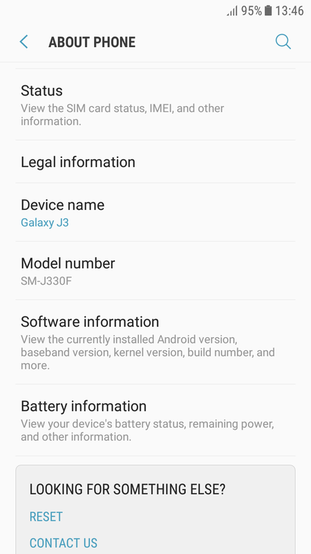

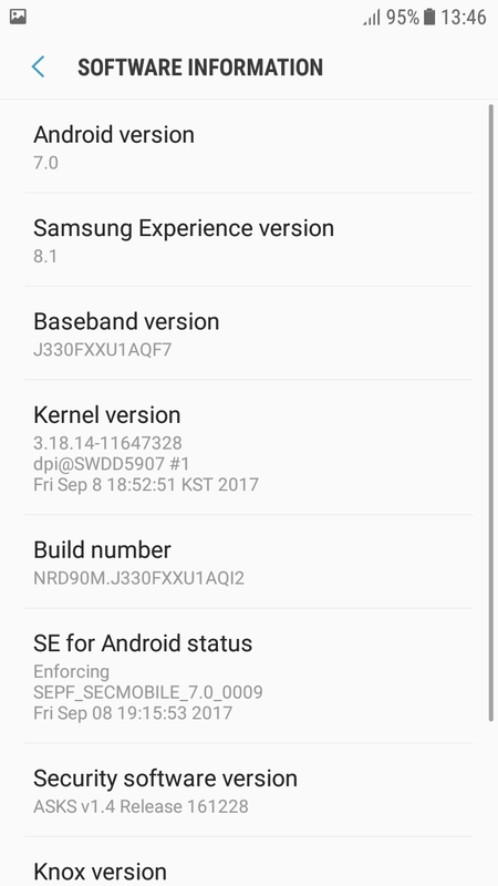

unit ; J3 SM-J330F

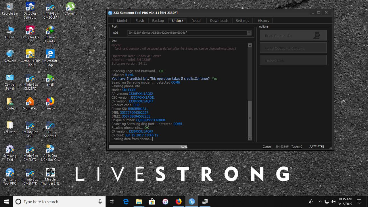

pag ok na yan connect sa pc open z3x select proper model
screenshoot info
fallout 2 redding

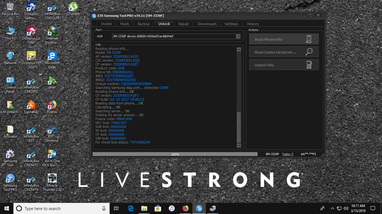

click read code via server and it will consume 5credit..then select read code via server diag
calculate codes shown

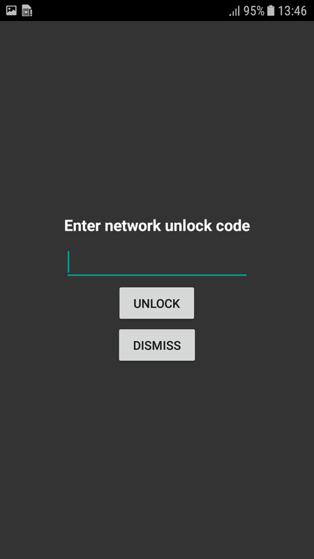

enter na ang codes sa unit
done...
