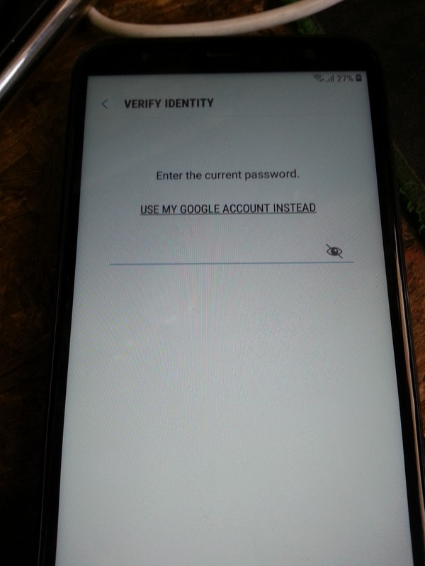

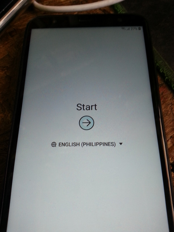

share ko lang po J4 plus frp po ndali s tricks
e2 po xa nung dinala sken
e2 po ginwa kouna po press and hold po ng 2 fingers ung screen
hanggang magopen ung talkback
pagopen ng talkback same procedure lng nung ibang samsung ndi ko n po npicturan
write po ng L,then select talkback settings
at pra nmn po mgoff ung talkback hold po ng sbay
ang volume up and down
kapap ngkaring n po ng google chrome type po e2
frpfile.com/bypass tpos idownload po itong 2 then install
unahin po ung google account manager
tpos po open ung frp bypass pagka-install
tpos po click ung 3 dots s taas then browser sign in
sign in nyo n lng po ung google account nyo
yan po account added na alam n kasunod nyan
yan po done
delete nyo n lng ung nksign in nyo n google s settings..
