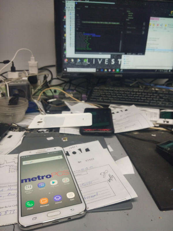

first downgrade to 6.0.1
sa samobile meron dun 7.1.1 at 6.0.1 the same binary file ...
let proceed downgrade to 6.0.1
comerica atm locations

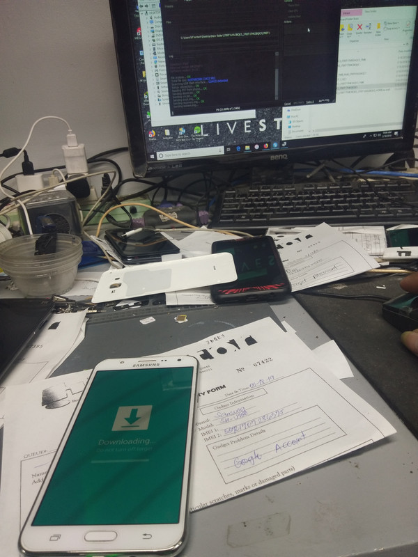

after downgrade flash this file
after flash enable na adb nyan at pede na bypass...
using any bypass tool..

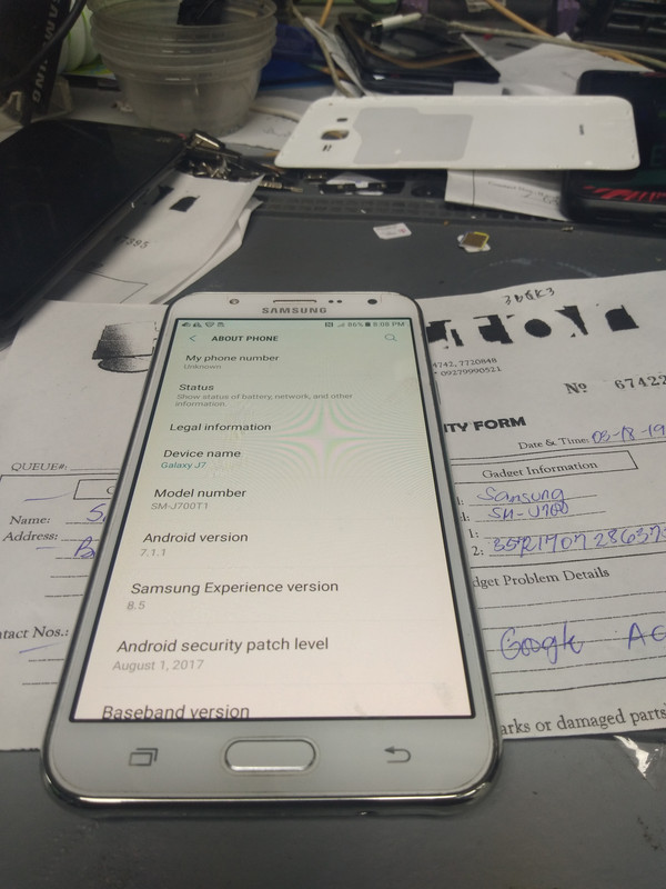

after bypass balik sa 7.1.1 version by flashing again 7.1.1 rom galing sa samobile..
finish product

note wag mo ishort cut iflash yun boot file kc di mag dididsplay yan sa menu hanggang samsung lang tapos black na...
