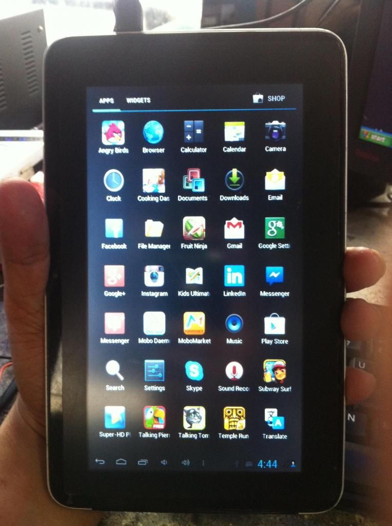

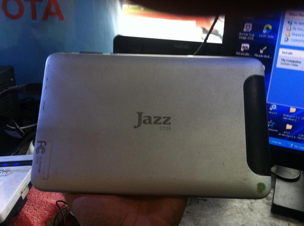

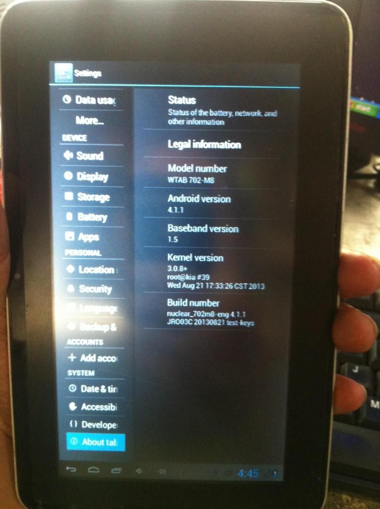

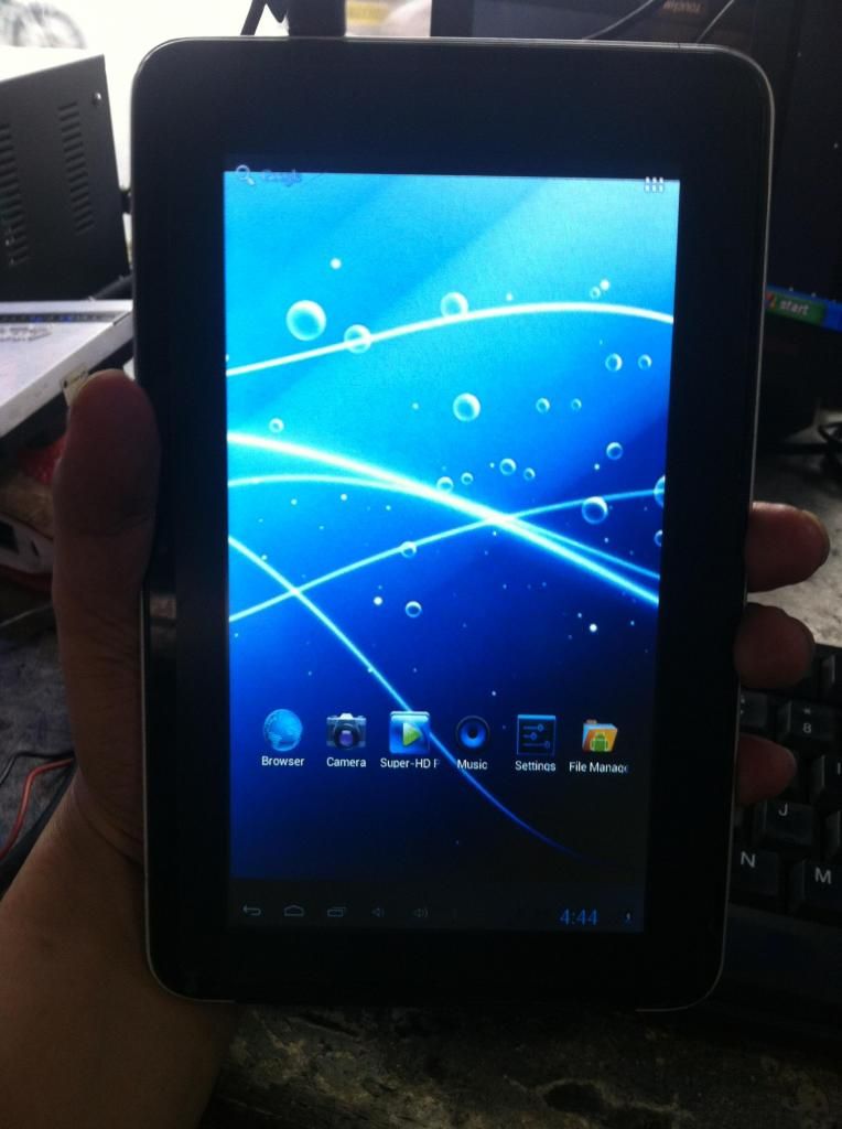

PROBLEM NO POWER
JAZZ 7 INCH TABLET
BOARD ID <ba13_777_v2.1>
CPU TYPE <A13>

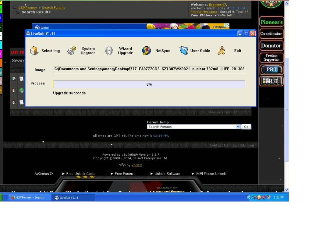

FIRMWARE LINK
http://www.4shared.com/get/ozX54OFgc...702_M4_M8.html
LIVESUIT FLASHER LINK
http://www.4shared.com/rar/nYVFMDemce/livesuit_111.htm

THANKS SA PAG VIEW.
TAKENOTE: MGA KA-PIO CAMERA AT WIFI DI GUMAGANA
PERO OK LANG KAY TOMER BASTA MALARO LANG DAW MASAYA NA SYA
