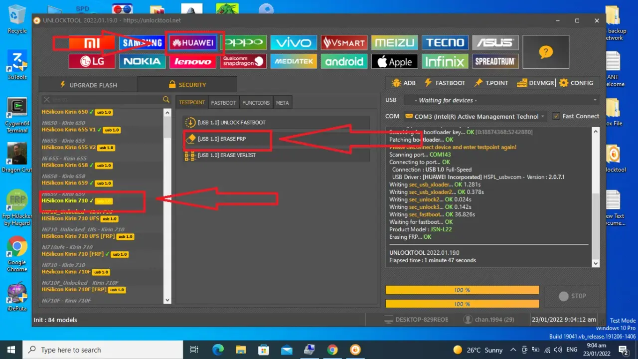

Open baklas agad unit and make test point and saksak usb.
Now open unlocktool and click 'HUAWEI' tab and click 'HiSilicon Kirin 710 then click [USB 1.0] FRP
Take note 2 times po pag testpoint niyan. Nasa description naman po kung kelan ite-test point ulit

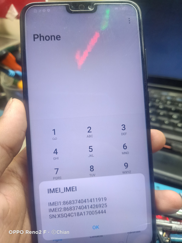

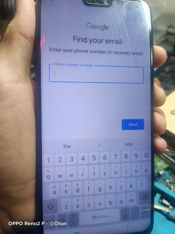

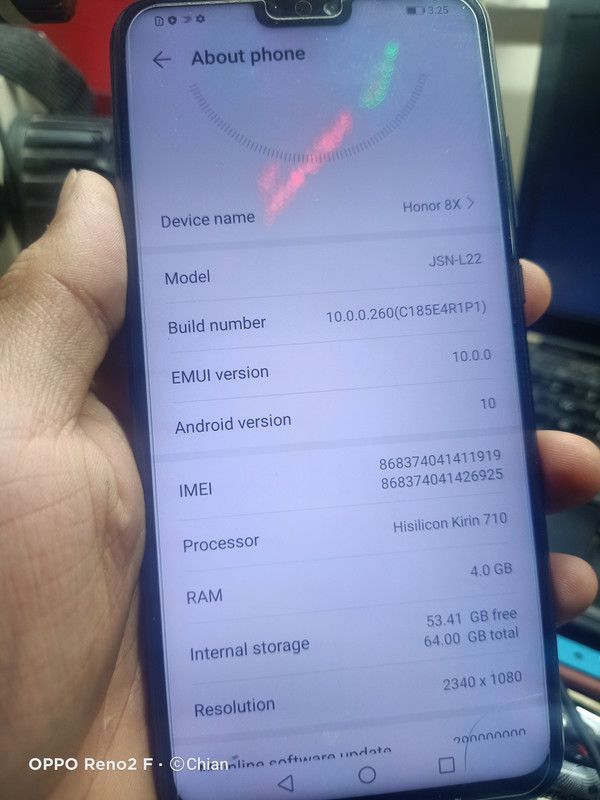

At heto naman po ang proof ko
