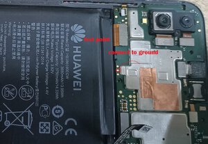

testpoint:
procedure:

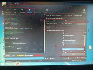

open hydra main tool, and it's ok to proceed test point first,
(take a look the picture given above}
and now you can remove frp freely, just follow the picture i have edited below
done!
