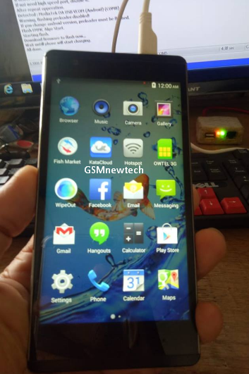

KATA M2 monkey virus DONE with tested firmware
step 1: open sp flashtool
step 2: select scatter file
step 3: click download
step 4: turn off phone and insert usb while holding the vol +
step 5: smile while waiting
step 6: collect the money kay tumer
download firmware here
for password 09755555701
or pm me
make sure na click nyo ang thanks button and may mga post na kau dto sa ANTGSM.COM
DONE heart heart heart

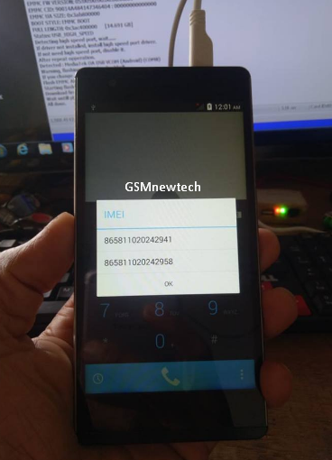

update ko lang po
TESTED ito
Note: m2 16gb ko siya tested

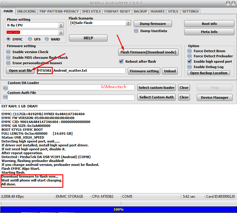

repply ko nalang po dito ang result ng files ni sir dangerous26 tested po

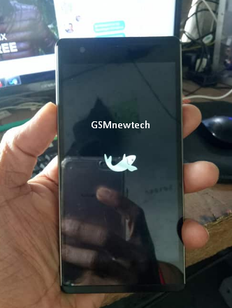

ngaunlang may naligaw sakin
hang logo sakin flash ko sa nck box
Brand : Kata
ProdName : Kata_M2
ProdModel : M2
Device : M2
AndroidVer: 4.4.2
MTKxCPU : MT6582
MTKxPRJ : ALPS.KK1.MP1.V2.10
