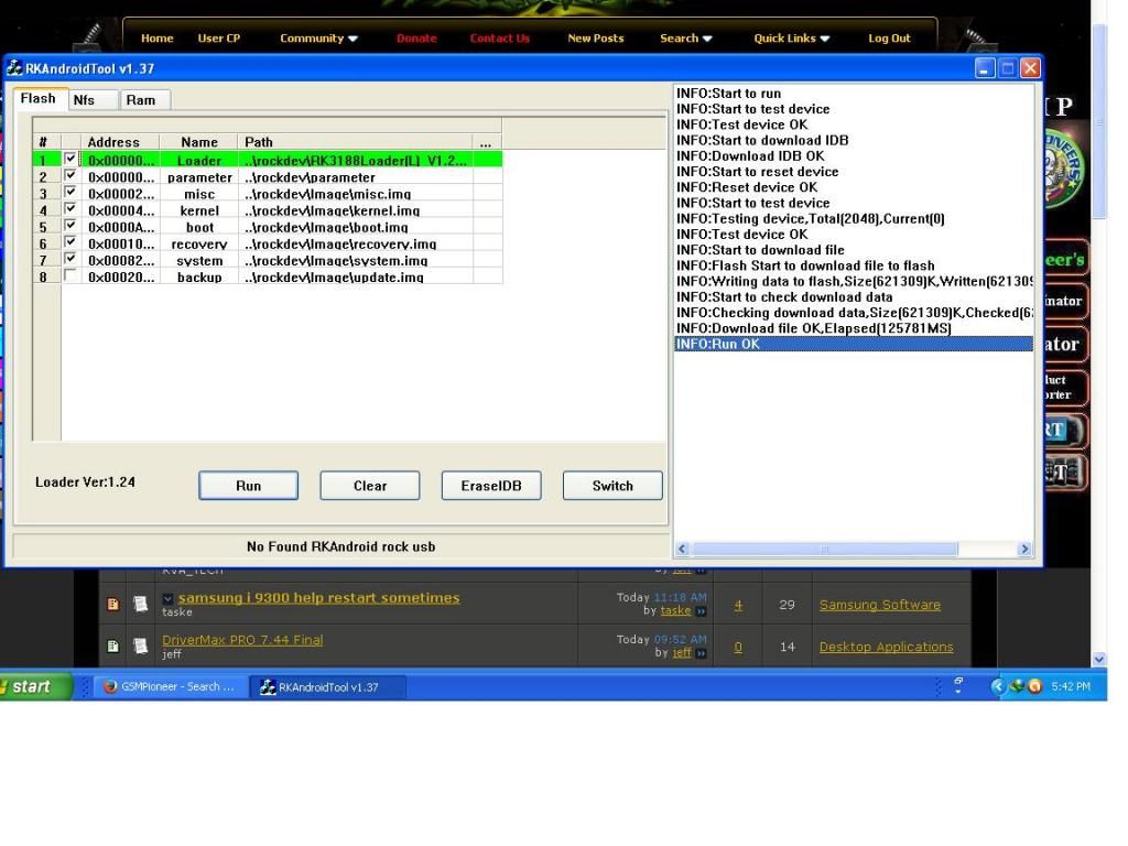

BUKSAN ANG FOLDER. RKAndroidTool V1.37
WALA NG BABAGUHIN DYAN DAHIL AUTO LOAD NA YUNG FIRMWARE
1. POWER OFF SI TABLET OR RESET MO YUNG BUTTON.
2. PRESS VOLUME+ AND POWER INSTALL DRIVER PAG WALA KA DRIVER BROWSE MO SA MISMONG TOOL DRIVER. COMMON SENSE
3. CLICK RUN SA R.KTOOL WAIT TILL FINISH AND PRAY SANA SUCCESS
