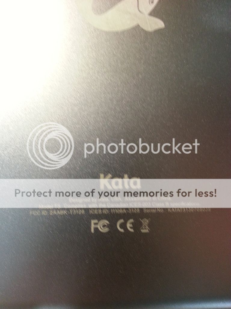

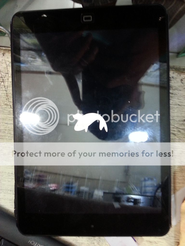

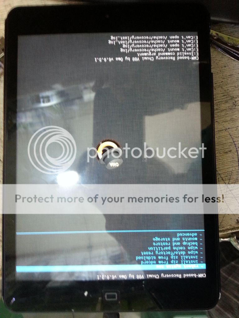

ibahagi ko lang po mga boss... nagawa ko ngayon KATA t3 tablet wala po siyang power...
ito po yong unit...
<textarea style="width: 500px;" readonly="readonly" class="ncode_imageresizer_warning" id="ncode_imageresizer_warning_1">Click here to view the original image of 768x1024px.</textarea>
<textarea style="width: 500px;" readonly="readonly" class="ncode_imageresizer_warning" id="ncode_imageresizer_warning_2">Click here to view the original image of 768x1024px.</textarea>

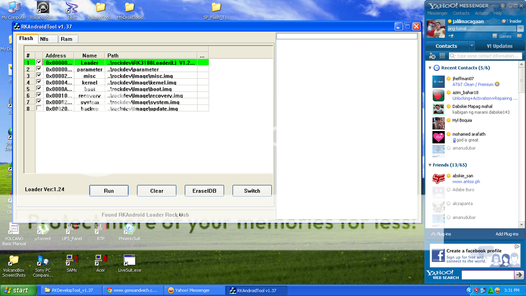

ito po yong procedure...
1. POWER OFF SI TABLET OR RESET MO YUNG BUTTON.
2. PRESS VOLUME+ AND POWER INSTALL DRIVER PAG WALA KA DRIVER BROWSE MO SA MISMONG TOOL DRIVER. COMMON SENSE
3. CLICK RUN SA R.KTOOL WAIT TILL FINISH
flash ko na po...

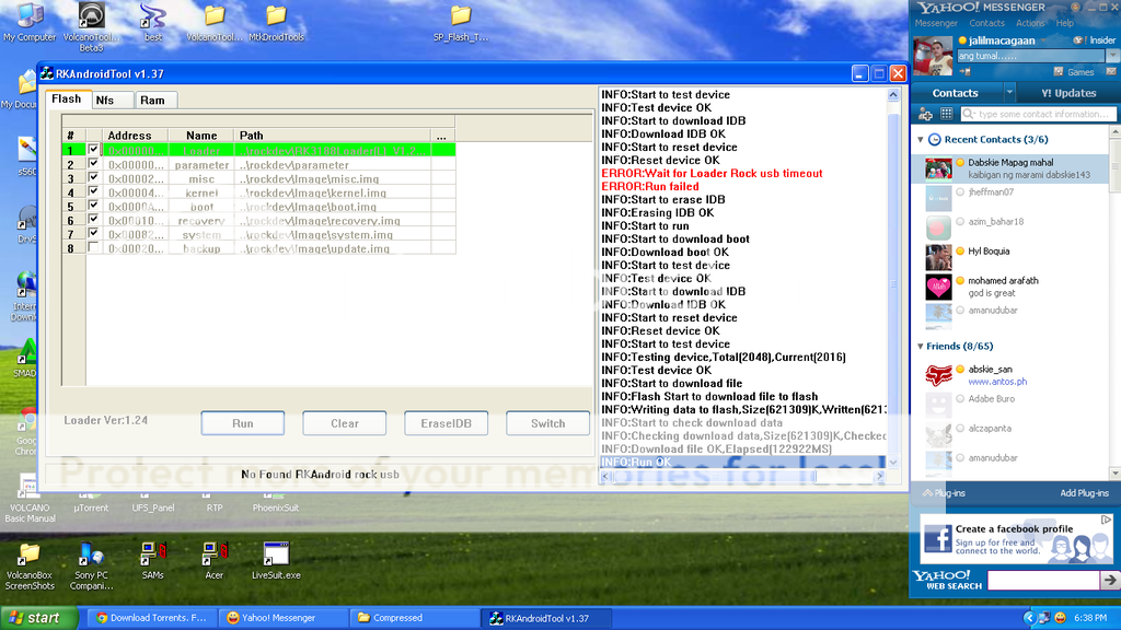

<textarea style="width: 500px;" readonly="readonly" class="ncode_imageresizer_warning" id="ncode_imageresizer_warning_6">Click here to view the original image of 879x494px.</textarea>
ito po tapos na e flash...
<textarea style="width: 500px;" readonly="readonly" class="ncode_imageresizer_warning" id="ncode_imageresizer_warning_5">Click here to view the original image of 879x494px.</textarea>

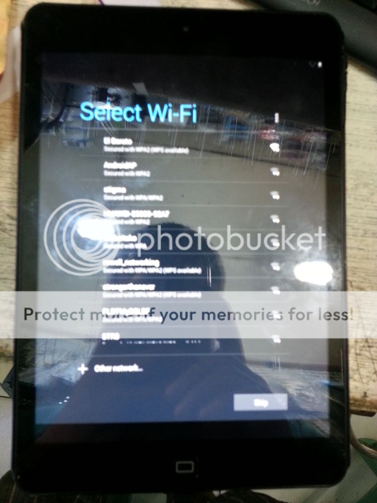

pag natapos po eflash.. ito po yong lalabas sa unit... reboot mo nalang..
<textarea style="width: 500px;" readonly="readonly" class="ncode_imageresizer_warning" id="ncode_imageresizer_warning_3">Click here to view the original image of 768x1024px.</textarea>

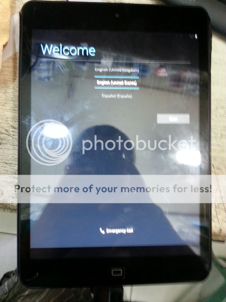

ito po ok na po yong unit...
<textarea style="width: 500px;" readonly="readonly" class="ncode_imageresizer_warning" id="ncode_imageresizer_warning_4">Click here to view the original image of 768x1024px.</textarea>
