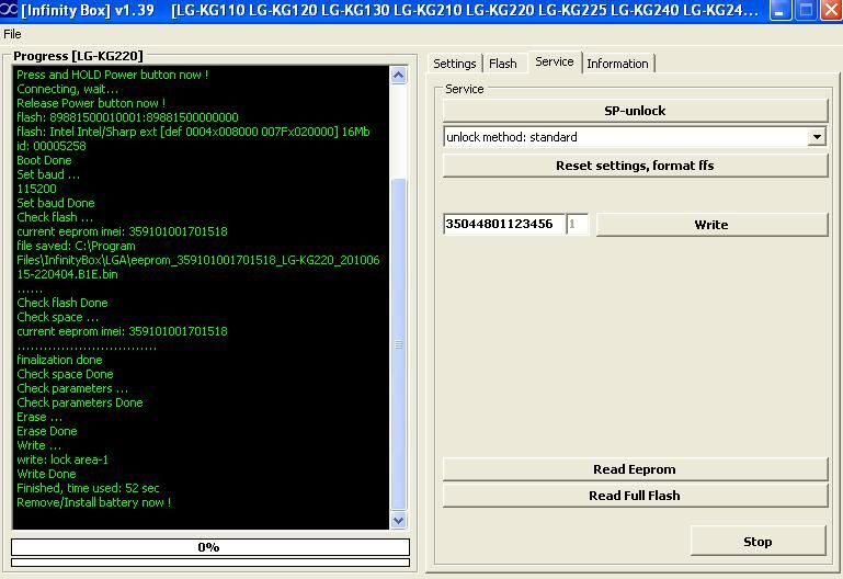

KG220 (O2 locked) unlocked and change to arabic language
unlock first:
you need the ff:
infinity box/sw
lg-7050 cable
sp unlock
press power key
change language to arabic, download files from support site

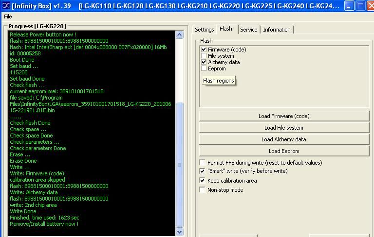

KG220P40-ARB-V10g-000-00_OCT-10-2006_CodeData_w_calibration[1].B1M
KG220P40-ARB-V10g-000-00_OCT-10-2006_AlchemyData[1].B1P
logs in flashing
COM10 [VCP0] selected
module v1.39
Device: LG-KG220
Checking data, wait...
advanced flash detection enabled
Action: flash write
Write: Firmware (code)
Skip: File system
Write: Alchemy data
Skip: Eeprom
"smart write" active
"keep calibration" active
Boot ...
Phone should be Switched OFF !
Press and HOLD Power button now !
Connecting, wait...
Release Power button now !
flash: 89881500010001:89881500000000
flash: Intel Intel/Sharp ext [def 0004x008000 007Fx020000] 16Mb
Boot Done
Set baud ...
115200
Set baud Done
Check flash ...
current eeprom imei: 359101001701518
file saved: C:\Program Files\InfinityBox\LGA\eeprom_359101001701518_LG-KG220_20100615-221921.B1E.bin
Check flash Done
Check space ...
Check space Done
Check parameters ...
Check parameters Done
Erase ...
Erase Done
Write ...
calibration area skipped
Write: Alchemy data
write: 2nd chip area
Write Done
Finished, time used: 1623 sec
Remove/Install battery now
unlock first:
you need the ff:
infinity box/sw
lg-7050 cable
sp unlock
press power key
logs in flashing
module v1.39
Device: LG-KG220
Action: flash write
Skip: File system
Write: Alchemy data
Skip: Eeprom
Boot ...
Connecting, wait...
Boot Done
Set baud ...
115200
Set baud Done
Check flash ...
Check flash Done
Check space ...
Check space Done
Erase ...
Erase Done
Write ...
Write: Alchemy data
Write Done
