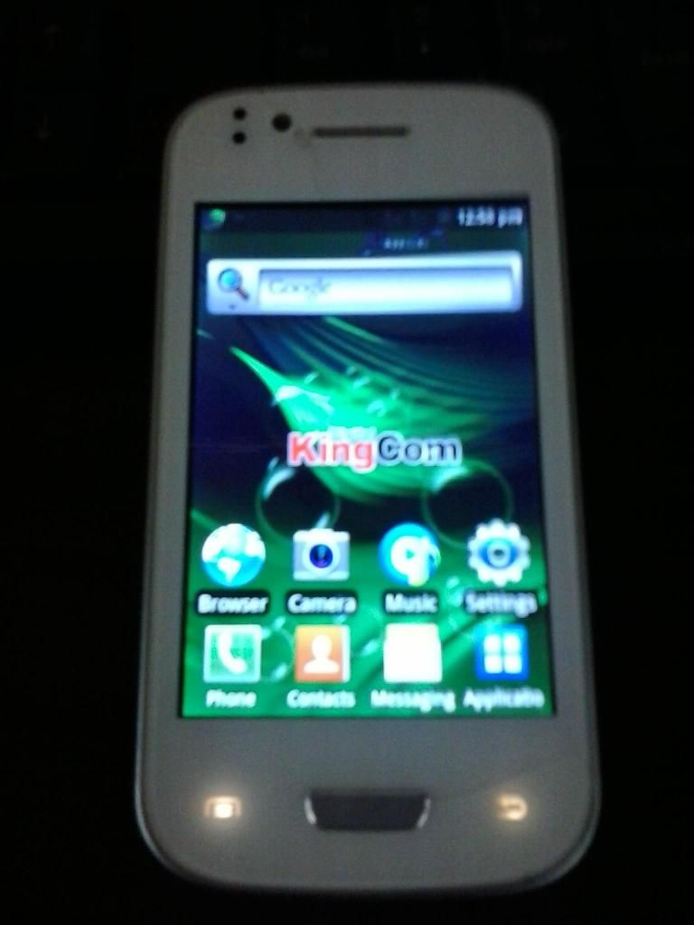

Kingcom Android 351
Problem
Too Many Patterns Attempt (TMPA)
Solution/Procedure

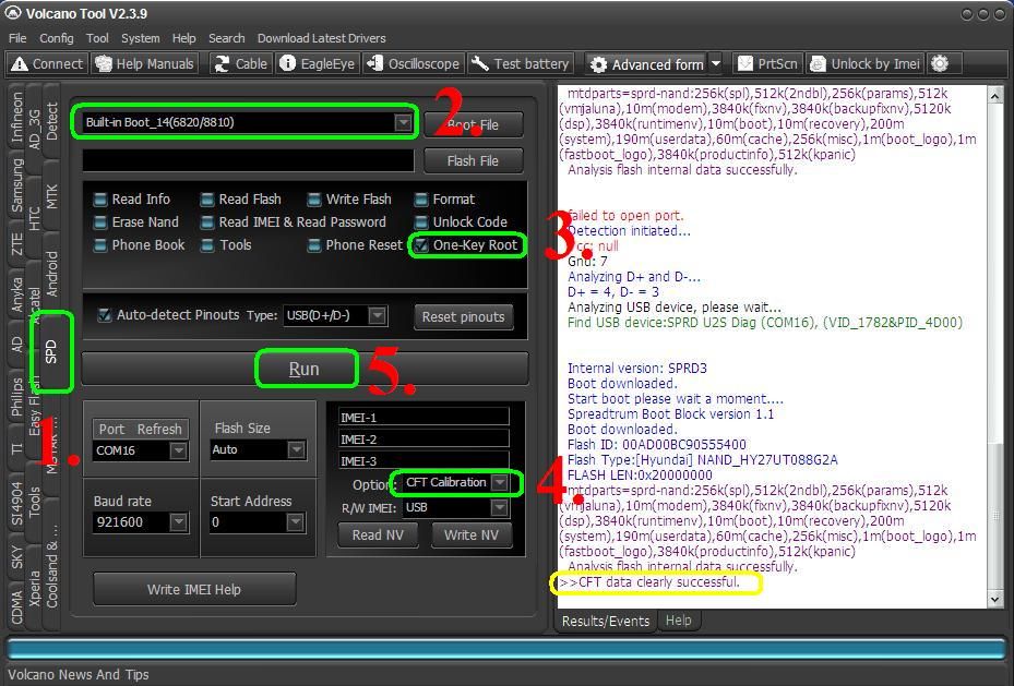

1. Run Volcano Exe (2.3.9)
2. Click SPD
3. Adjust Built-in Boot to (6820/8810)
4. Check One Key Root
5. Select Option (CFT Calibration)
6. Then Tick RUN
Or follow the screen captured below
Finish Product
2. Click SPD
6. Then Tick RUN
Finish Product
