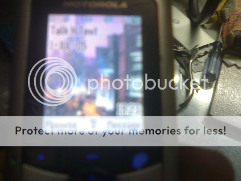

ito na ang unit after operation

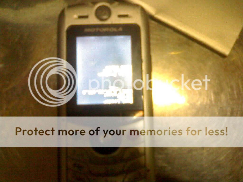

unit: L2
history/status:
pag bootloader mo sya baliktad ang image sa screen
and im sure na naiflash in wrong firmware ng unang humipo

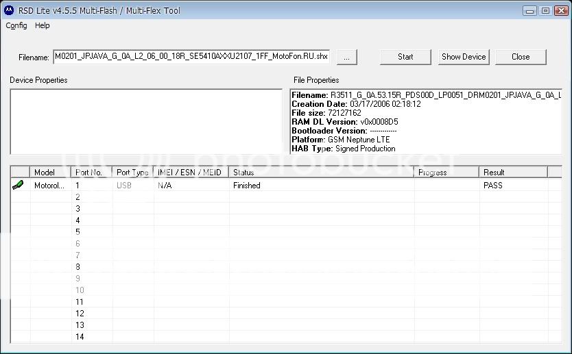

kc ito ang file properties
Code:
Filename: R3511_G_0A.52.26R_PDS00A_LP000D_DRM0201_JPJAVA_G_0A_L6_06_00_17R_SE5408AXXJ8098_1FF.shx Creation Date: 11/22/2005 01:49:40 File size: 71950746 RAM DL Version: v0x0008D0 Bootloader Version: ------------- Platform: GSM Neptune LTE HAB Type: Signed Production
L6 firmware ang nakapasok sa kanya
ito sya
@ ito device properties
Code:
EMEI/ESN: N / A Technology: N / A Software Version: N / A Flex Version: N / A Boot Version: N / A DRM Version: N / A
Action tacken:
flash ko using RSD lite w/o TP success

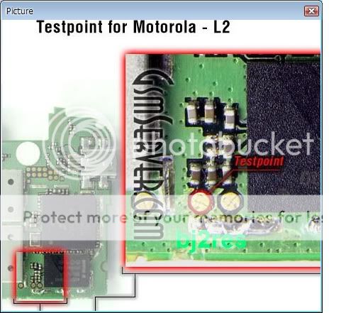

den subsydy password humingi after flashing so kelangan na nating iunlock

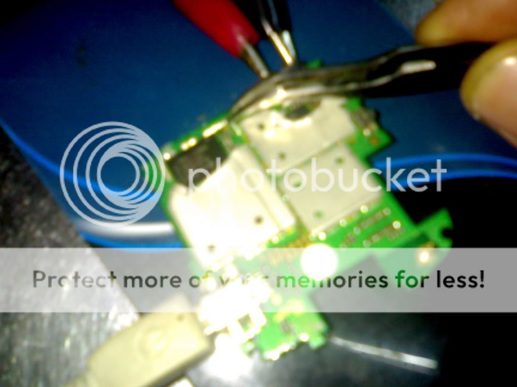

i unlocked it w/ TP dis time di supported sa w/o TP sa mstool
Testpoint guide
actual TP

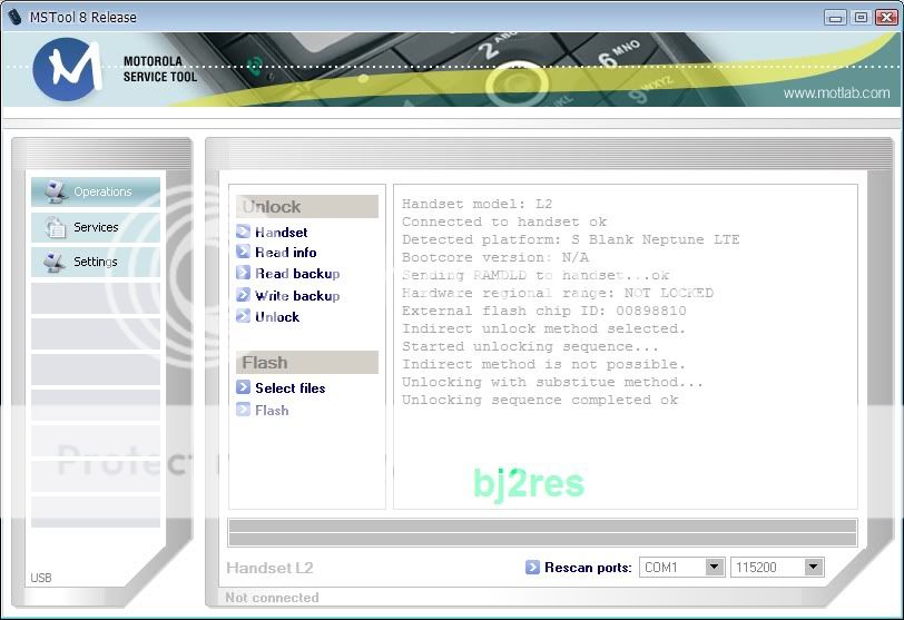

logs:
Code:
mstool unlocking via TP Handset model: L2 Connected to handset ok Detected platform: S Blank Neptune LTE Bootcore version: N/A Sending RAMDLD to handset...ok Hardware regional range: NOT LOCKED External flash chip ID: 00898810 Indirect unlock method selected. Started unlocking sequence... Indirect method is not possible. Unlocking with substitue method... Unlocking sequence completed ok
screenshot:
ito na ang device properties
Code:
IMEI/ESN/MEID: N / A Technology: GSM 900/1800-1900 Software Version: R3511_G_0A.53.15R Flex Version: SE5410AXXU2107 - 2.0.1.R3.2.R4.P2.0.3.P2.31.51.P2.0.R5.R4.15.P2.P2.R5 Bootloader Version: N / A DRM Version: 0201

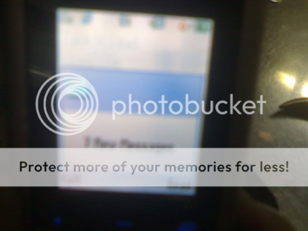

sa wakas na tapos rin
wait lang may nag txt
