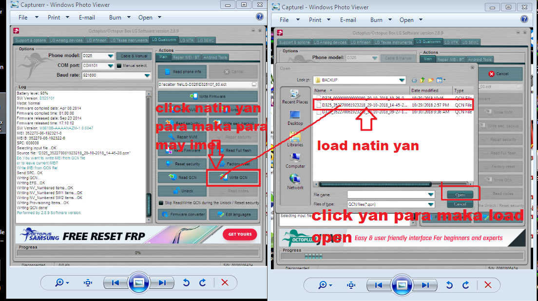

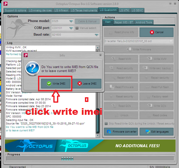

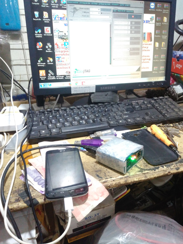

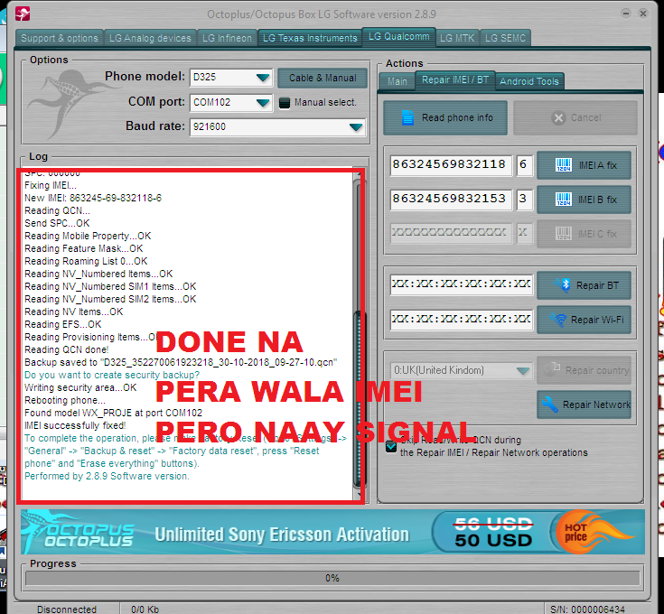

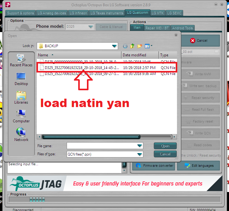

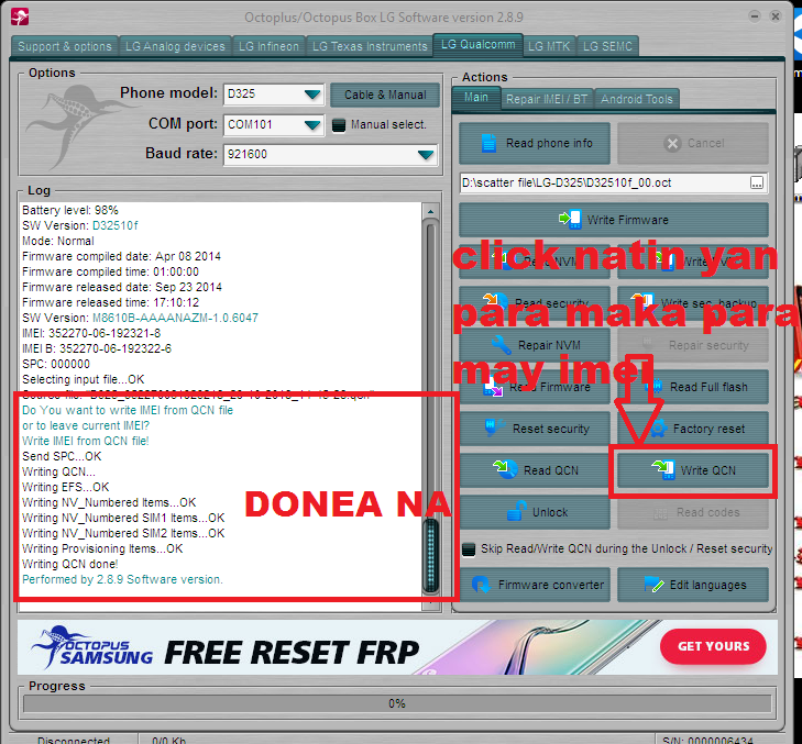

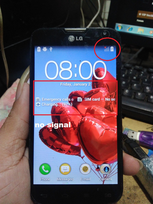

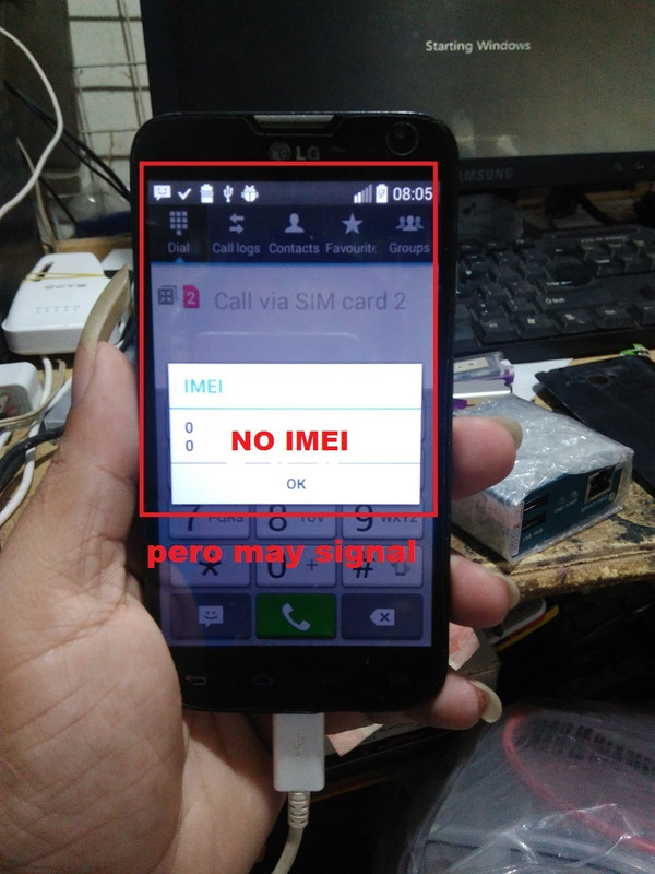

GOOD DAY MGA IDOL KO SHARE KULANG ETO NAGAWA KO L70 LG-D325 NO SIGNAL GALING NA SA IBANG SHOP ILANG MONTH NA 2LOG BINAKLAS NA NILA UNIT BUTE HINDE GINALAW PISA PARA SIGNAL KAYA NAG ISIP KO MONA ANO GAWIN KO KAYA OPEN KO OCTOPLUS SA LG ETO GUIDE PAKI SUNDAN
OPEN LG SOFTWARE SA OCTOPLUS

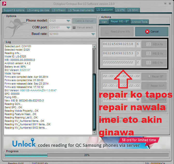

REPAIR KO IMEI
PAKE SUNDAN NALANG ETO GUIDE
RESTART NATIN UNIT

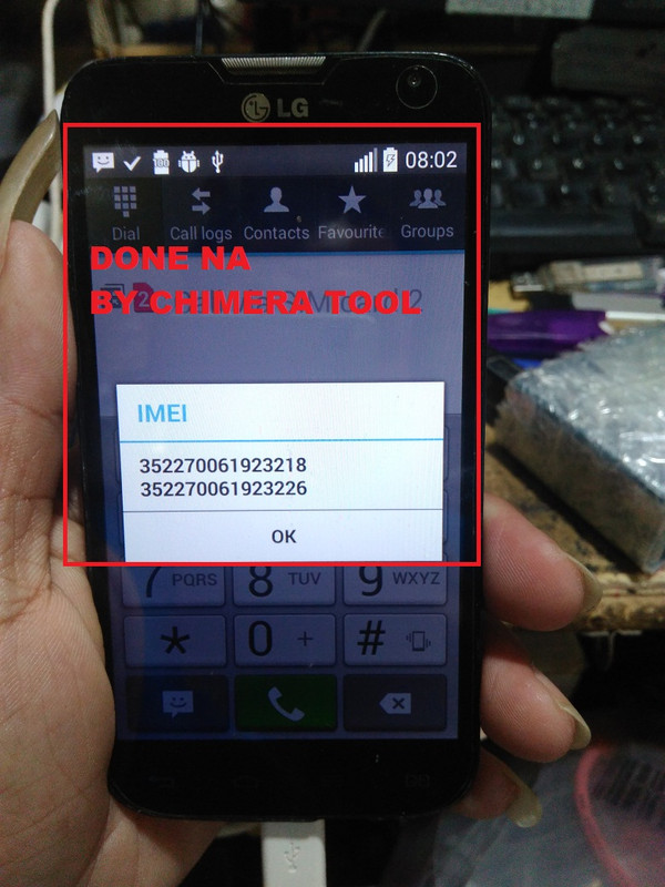

DONE MAY SIGNAL AT IMEI SALAMAT SA PAG VIEW
