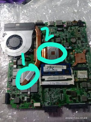

Bumubukas pero pag umiinit na ung sa may processor nawawala na display niya at bigla na lng mamatay

possible thermalfuse po issue need mo po dapat dianosed at dapat po alam nyo po ang basic knowledge po reading ng scheamatic diagram mallaman po nyo agad ang issue
Try mo po muna linisin ung fan, then palit thermal paste(Basic). If same issue pa din saka ka na mag advance thermal sensor, bios etc. Kailangan marunong kang magbasa ng schematic/boardview.
sir nakagawa nako nyan check vcore line po.. posible my leak po na isang mosfet yan
try to isolate those fan if is spinning like a wheel.. clean the CPU and put some thermal grease on it.. if the problem persists you may need a chip-level tech who is knowledgable in handling that issue..
