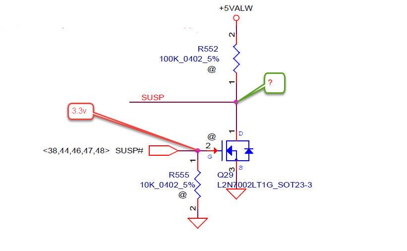

Question: Given the circuit below:
1. if SUSP has 5v before and after power button is pressed, what could be the problem?
2. if SUSP has 0v before and after the power button is pressed, what could be the problem?
3. What is the normal operation of this circuit in terms of voltage readings at SUSP# and SUSP?
UPDATE:
this circuit is commonly used in many laptop designs so understanding this basic circuit will help us solve problems related to discharge circuit and control signals such as syson, susp#, s5_on, etc.
SOLUTION:
1. Q29 is faulty. The drain to source pin of the MOSFET is open, therefore, SUSP = +5VALW
2. There are two potential fault in this scenario: Q29 is faulty. The drain to source pin is shorted or R552 is open.
3. This circuit design is an analog equivalent of a digital inverter with voltage level shifting capability. Since this is an inverter circuit, if 3.3v is present at SUSP#, then SUSP should be 0v. If SUSP# = 0v, then SUSP = +5VALW.
UPDATE:
SOLUTION:
