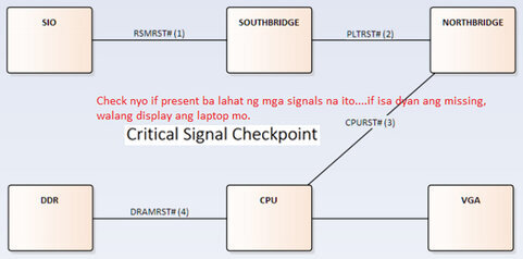

• Using critical signal checkpoint and power sequence summary, measure
• PLTRST# at pin 22 wifi slot - 3.3v
• DRAMRST# at pin 30 DDR slot –1.35v/1.5v/1.8v
• Activity in data lines in display ports (vga, lvds and hdmi) using oscilloscope

Troubleshooting Guide No Display Issue​
• Perform level 1 problem isolation
• Perform visual inspection and check for corrosion and burnt components.
• Perform basic tests
• External keyboard if responding or not
• External monitor if display comes out
• Remove attached Bluetooth/wifi module
• Replace w/ known good memory
• Replace w/ known CPU
• Clean the board via sonic machine if needed
• Make sure the following is normal
• Current-sense resistance and voltage is normal- 1Mohm or higher
• Current consumption is normal in S5 state – (pagsaksak sa dc bench power supply dapat 0.01A or less)
• Use the current jump method to verify that the board powers up properly.
• A good/working laptop would roughly have current consumption jumps approximately 4-6 times before initializing the OS
• The number of jumps depend on several factors:
• Type of CPU
• with or without GPU
• Flash with stock System BIOS to make sure the problem is not firmware-related
