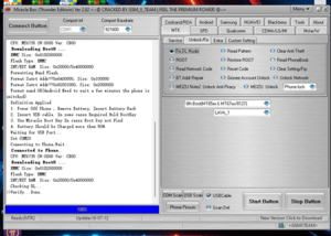

LAVA IRIS 60 nka FRP LOCK
Tools: Miracle Crack
pasundan nalang sa pic sa procedure.
Service/ click format
boot: 8th boot / LAVA_1
check -auto
check-advance frp
after may magpop up.. select lang frp at data
done

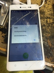

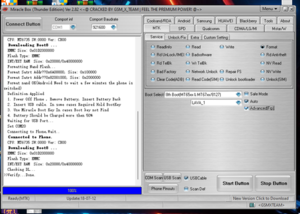

after mareset frp mag DL image Fail yan
sundan ulit pic
after mafix.. wait magboot
may error encryption ynsuccesfull
click lang RESET PHONE
wait mag reset
ok na yan mga master.. fix na ung error..

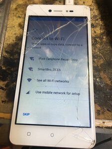

wait magboot
setup lang ..
DONE.
