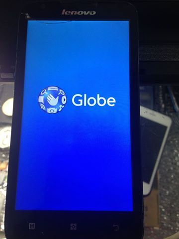

Problem:
Hang on logo
dito ako kumuha ng file, credits to the owner

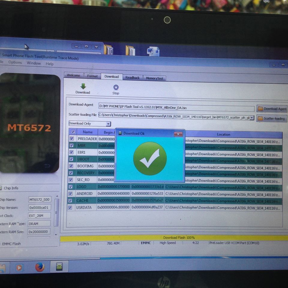

Procedure
1.Open sp flashtool and load firmware
2.Select download only and press volume down para madetect
3.Wait until finish
FLASHING
DONE
thanks for viewing..
