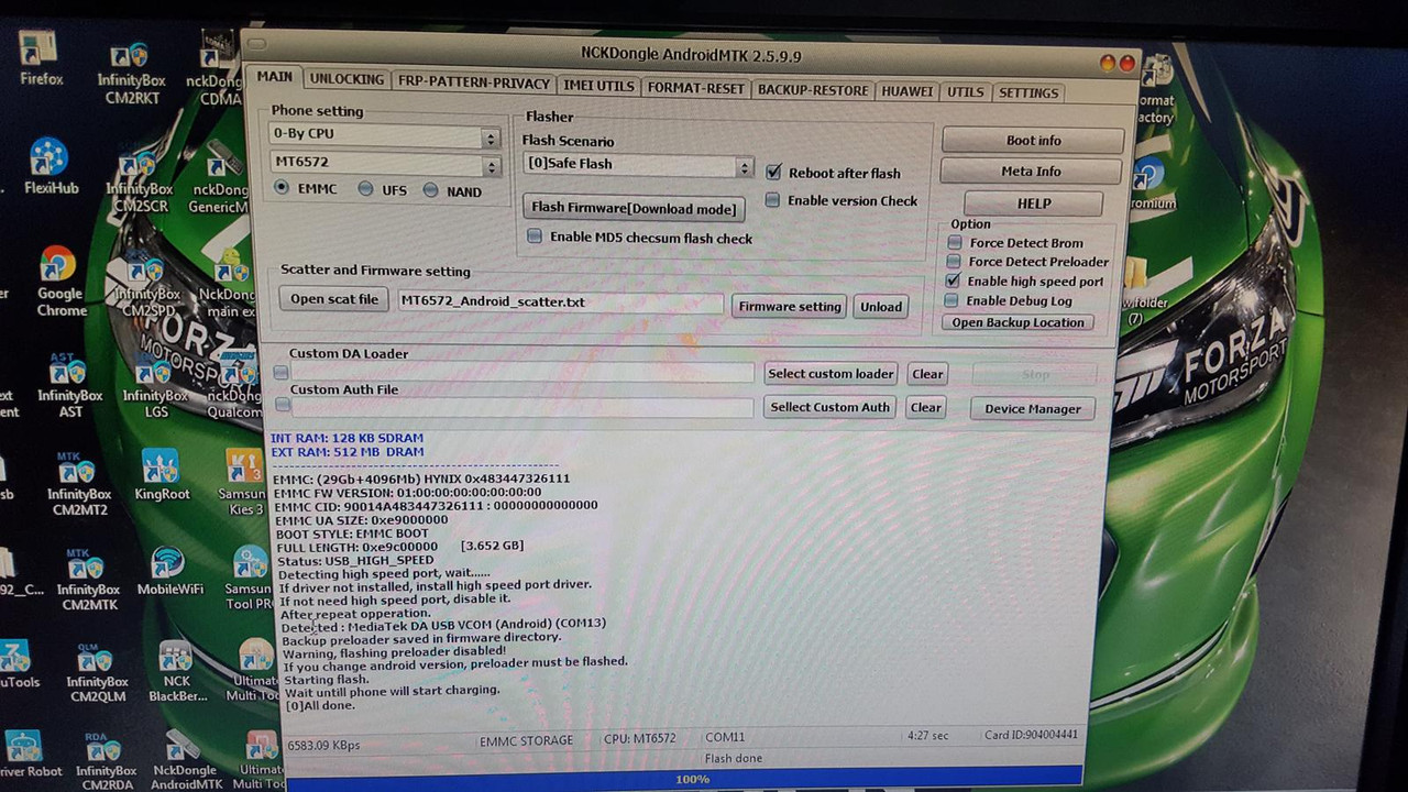

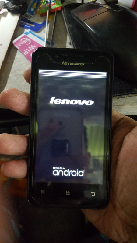

Unit : A319
Status : Hang On Logo
Procedure : Flashing via nck dongle
1. Open nck dongle
Here : https://mega.nz/#!kZhVGYzC!zciLQIGcxGDbMoJyQEI-7xwpPEznDD3p32mhaLiShXg
2. scatter and firmware setting
3. open scatter file
4. Click flash firmware
5. saksak usb s cp at hintayin matapos
Unit : A319
1. Open nck dongle
