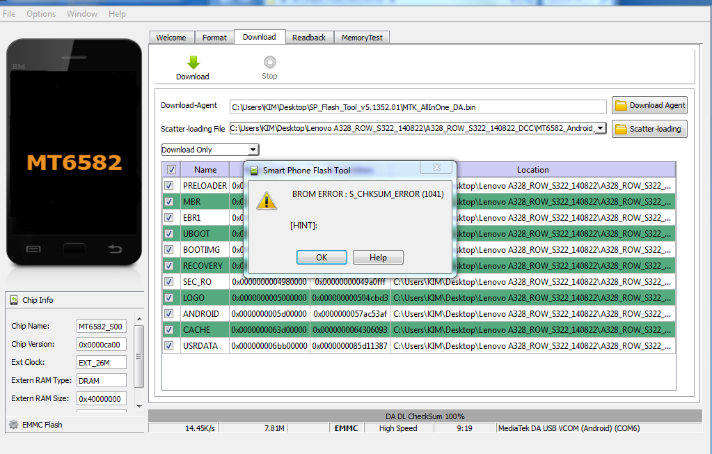

gud day po tanung ko lang po sino po nakaencounter ng ganitong problema
una lenovo a328 hang
flash using spft all version natry ko na complete flashing naman kaso pag dating sa da/dl checksum error na
pag uncheck ko s setting ng flash tool ok naman complete flashing but still hang on logo
eto screenshot
same problem sa o+ fab go ko kahit yung debrand na firmware
try ko firm upgrade at format all ayun deads n
help po
note. tested po firmware dahil nagamit n po many times.
ok din flashtool kasi gamit ko din pang flash s other unit
erase mu ung checksum sir...ung xa folder nia..kasama xa firmware nia..
pag ganyang status boss..kadalasan need mo BIN FILE NYAN...
TRY mo format all sa miracle..kapag nag error... need mo tlaga bin file boss..
