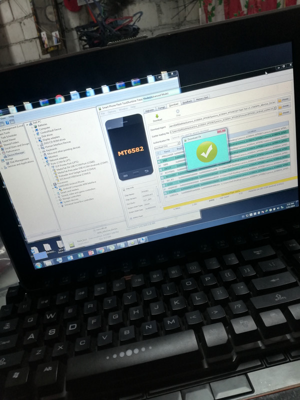

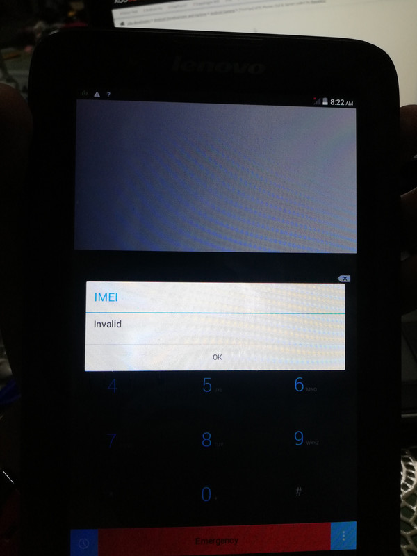

issue: launcher has stopped diko ma format sa stetting and di ma hr kaya nag try ako mag flash ito step mga boss sundan nyo lang
1: NEED NYO DOWNLOAD TONG FIRMWARE NATO LINK
2: EXTRACT NYO FILES TAPOS ANDYAN NA LAHAT NG NEED NYO FW AND SPTOOL

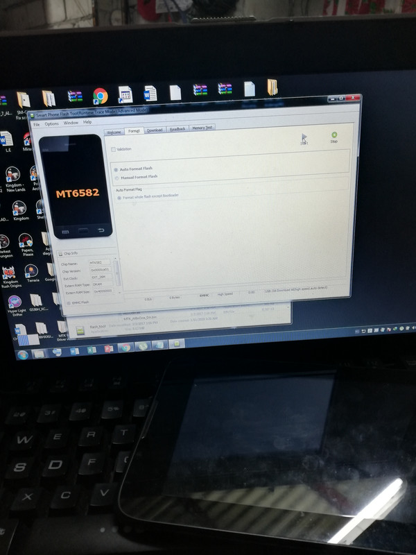

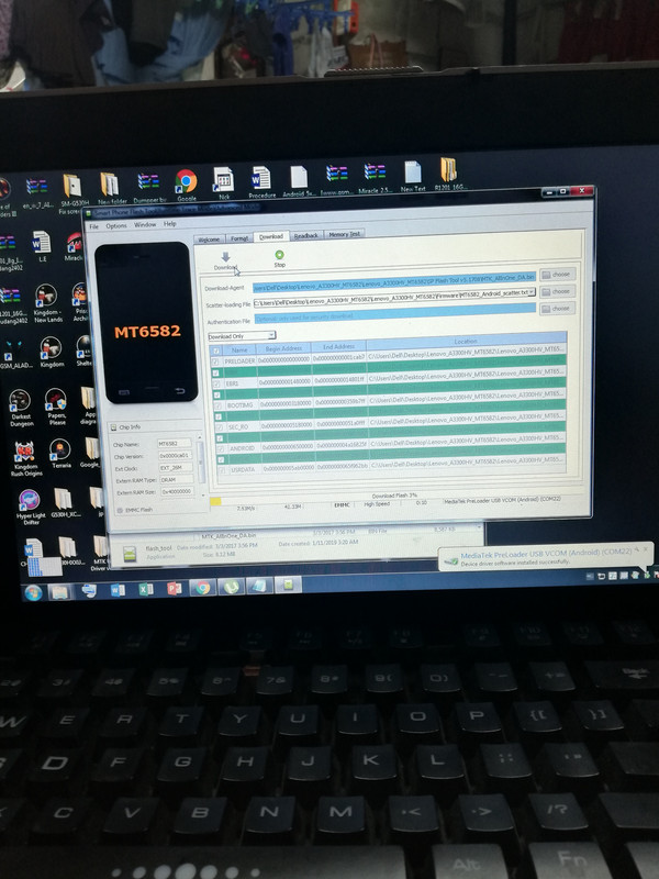

3: OPEN NYO SP FLASHTOOL TAPOS CLICK CHOOSE TAS CLICK NYO KUNG SAN NKALAGAY FW TAS PAGKA NA LOAD NA SCATTER FILE NYO PUNTA KAYO SA FORMAT CHECK NYO NLNG SS SA BABA MGA BOSS
4: OFF NYO TAB TAS PRESS NYO LANG VOL + TAS MAG CONNECT NAYAN PAGKA NA FORMAT NA GANON DEN FLASH NYO NA CLICK NYO NA YUNG START BUTTON PAG LUMABAS NA MALAKING OKAY IBIG SABIHIN PERA NA HEHE

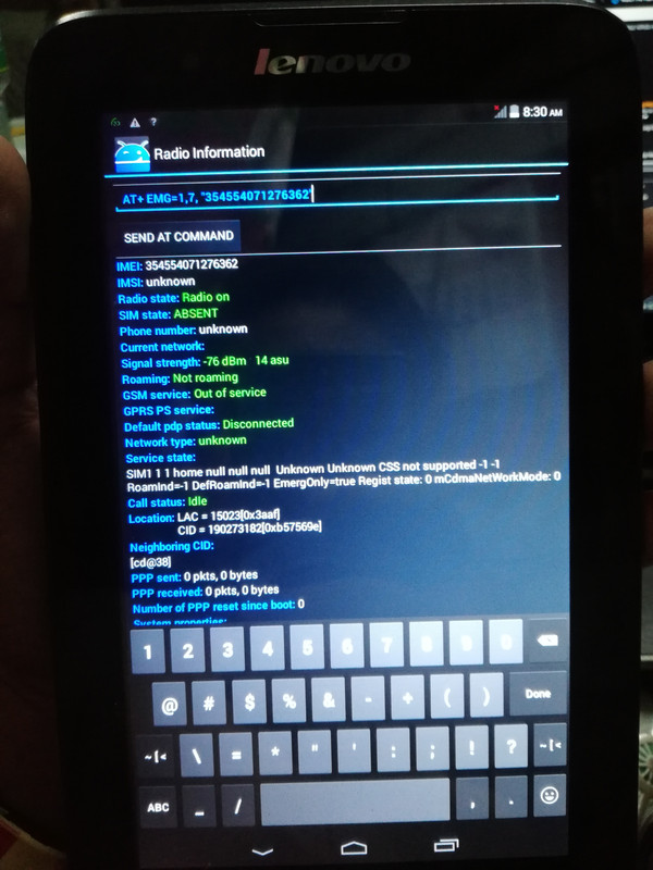

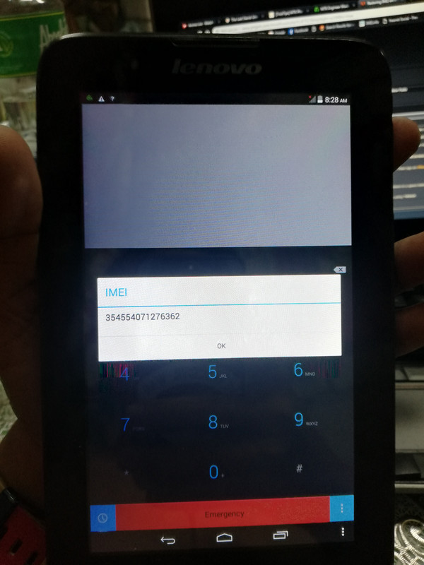

TAS MAWAWALA PALA IMEI NYAN GUYS KAYA ITO GAWIN NYO
1: PUNTA KAYO SA DIAL PAD TAS ITO TYPE NYO *#*#3646633#*#*
2: CLICK NYO CONNECTIVITY TAPOS CDS INFORMATION TAS REDIO IFO TAS PHONE 1
3: LALABAS DON AT+ EGMR=1,7, " IMEI " GANAYAN PO GAYAHIN NYO LANG TAS SEND COMMAND TAS REBOOT NYO TAB OKAY NAYON
