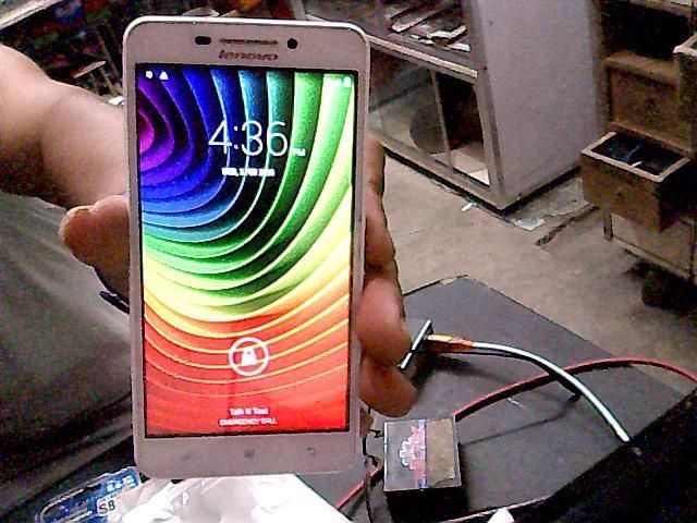

mates share kulang gawa ko ngayon pa unlock akala ko hindi kaya ng nck kasi wala yong model kaya try kulang
no root, direct unlock
open mtk android nck box
choose lenovo
choose lenovo a3600
click direct unlock
and it done
heres the logs
Selected connection metod: META Mode
Exe version: NCKBox AndroidMTK 1.8.6.4
Selected phone: Lenovo A3600
Scanning for presents meta ports...
Meta ports not detected, starting brom stage.
Curent Platform: MT6582
Phone must be off with battery inside.
Please insert USB cable now...
Detected(9) : PreLoader USB VCOM Port (COM9)
Starting META mode, wait...
Restarting, wait....
Restarting to meta,wait....
If drivers missing, please install CDC drivers.
This can take up to 5 min on slow phones.
If take too long, check device manager for drivers.
META Port Detected[67] MTK CDC Serial (COM67)
USB\VID_0BB4&PID_0005&MI_02\7&1F2F085E&0&0002
Start sync target, waiting responce.....
BaseBand CPU : MT6582, E01
SW_VER : MOLY.WR8.W1315.MD.WG.MP.V62.P5
HW_VER : LCSH82_CWET_LX_KK_HSPA_HW
Phone imei[1] : 868292027804594
Phone imei[2] : 868292027932601
Start direct unlock[SIM1]
Direct unlock done
Start direct unlock[SIM2]
Direct unlock done
Clean Boot flag ok.
All done.
finish product
