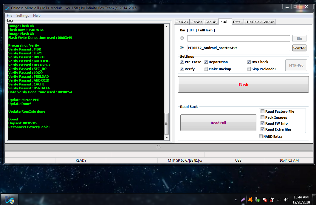

share ko lang mga boss itong tested firmware
na ginamit ko kanina,
ss
ss
Code:
Card found : S/N : 28FA2B58 , v0137
Chinese Miracle II [MTK module] v 1.58
Scatter Load Ok , BaseBand : MT6572 , Project : a516_row , Storage : EMMC
Files found : 12 , Set to Flash : 11
Created by Infinity-Box (c) Chinese Miracle II (c) 2016
Device Brand : Lenovo
Device Model : A516_ROW
Device CPU : MT6572
Device IntName : a516_row
Device Version : 4.2.2
Device Compile : 4/2/2014 9:28:25 AM
Device Project : A516_ROW_S122_1404021727
Device ExtInfo : Lenovo A516
Ready to Flash!
Operation : Flash [ v1.58 ]
======= Flash
Wait for phone...
Phone found! [ 11 ]
Sync...
Inital Boot Ok!
BB_CPU_PID : 6572
BB_CPU_NME : [MediaTek] MT6572_S00
BB_CPU_EXT : 0xCA01 , 0x8A00 , 0x0000
Processing BROM stage
Settings for BROM configured!
SecCfgVal : 0x00000000
BromVer : 0x00FF
BLVersion : 0x0001
Processing DA stage
DA Select done, will use MTK_AllInOne_DA_v3.3001.00.00
Sending and initialize DA ...
Running DA ver.4.2 on BBID : 0x88
NAND Flash : NOT INSTALLED
eMMC Flash : 1501004E355530304D02449642F29091
Initialize Memory ...
DRAM already initialized by Preloader
DAgent sent , init HW now
eMMC FlashIC initialized
[eMMC] : FLASH_VEN : 0x15 , OEM : 0100
[eMMC] : FLASH_INF : [SAMSUNG] , M00U5
[eMMC] : FLASH_CID : 1501004E355530304D02449642F29091
[eMMC] : FLASH_BRT : 0x00200000 , 0x00200000 , 0x00020000
[eMMC] : FLASH_LEN : 0x00000000E9000000
[eMMC] : FLASH_UCP : 3728 MiB [eMMC 4 GiB]
DEV RID : 0x50AC1F4A4C3572F3F4FF13E0C3F70897
INT RAM : 0x00020000
EXT RAM : 0x20000000 [512 MiB]
BOOT TYPE : EMMC_FLASH_BOOT
SOC VERIFY : C1
Boot Ok!
ScatCFG : BaseBand : MT6572 , Project : a516_row , Storage : EMMC
Setting : Flash Pre-Erase (Safe) : Enabled
Setting : AFF verify : Enabled
Setting : HW verify : Enabled
BL : Check HW compatibility
BL : BBID supported by BootLoader!
BL : Check eMMC compatibility
BL : eMMC supported by BootLoader!
BL : BatteryLevel : 3793 mV
BL : BatteryLevel Ok
BL : Flash Pre-Erase
Total blocks to Erase : 2
Erase : 0x0000000000600000-0x0000000000100000
Erase : 0x0000000002300000-0x00000000E5C20000
Flash Pre-Erase Done, time used : 00:00:00
SecCfg Passed , 1799
BMT remark not need. Will skip
Sending Preloader ...
Use : preloader_a516_row.bin
Preloader Sent , Init passed
PartCount : 0013
Update PMT by user request
Repartition Done!
Use FLN Mode
Processing : Flash Write
Flash now : MBR
Image Flash Ok
Flash now : EBR1
Image Flash Ok
Flash now : UBOOT
Image Flash Ok
Flash now : BOOTIMG
Image Flash Ok
Flash now : RECOVERY
Image Flash Ok
Flash now : SEC_RO
Image Flash Ok
Flash now : LOGO
Image Flash Ok
Flash now : PRELOAD
Image Flash Ok
Flash now : ANDROID
Image Flash Ok
Flash now : CACHE
Image Flash Ok
Flash now : USRDATA
Image Flash Ok
Flash Write Done, time used : 00:03:49
Processing : Verify
Verify Passed : MBR
Verify Passed : EBR1
Verify Passed : UBOOT
Verify Passed : BOOTIMG
Verify Passed : RECOVERY
Verify Passed : SEC_RO
Verify Passed : LOGO
Verify Passed : PRELOAD
Verify Passed : ANDROID
Verify Passed : CACHE
Verify Passed : USRDATA
Data Verify Done, time used : 00:00:54
Update Mirror PMT
Update Done!
Update RomInfo done
Done!
Elapsed: 00:05:05
Reconnect Power/Cable!
