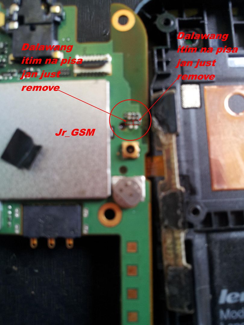

History---Reprogram same parin Kaya Decide Na ako NA buksan ang unit
First Move Punta ako agad Sa Volume Flex Remove Ko ang flex try ko power ang unit same parin
Procedure---sundan nalang ang picture
[URL=http://s1155.photobucket.com/user/Jr_gsm/media/20000101_092318_zpshb8yciew.jpg.html]
[/URL]

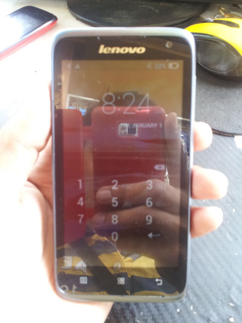

Test ko Unit ulit after remove ito na
[URL=http://s1155.photobucket.com/user/Jr_gsm/media/20000101_092819_zpswsuece1v.jpg.html]
[/URL]

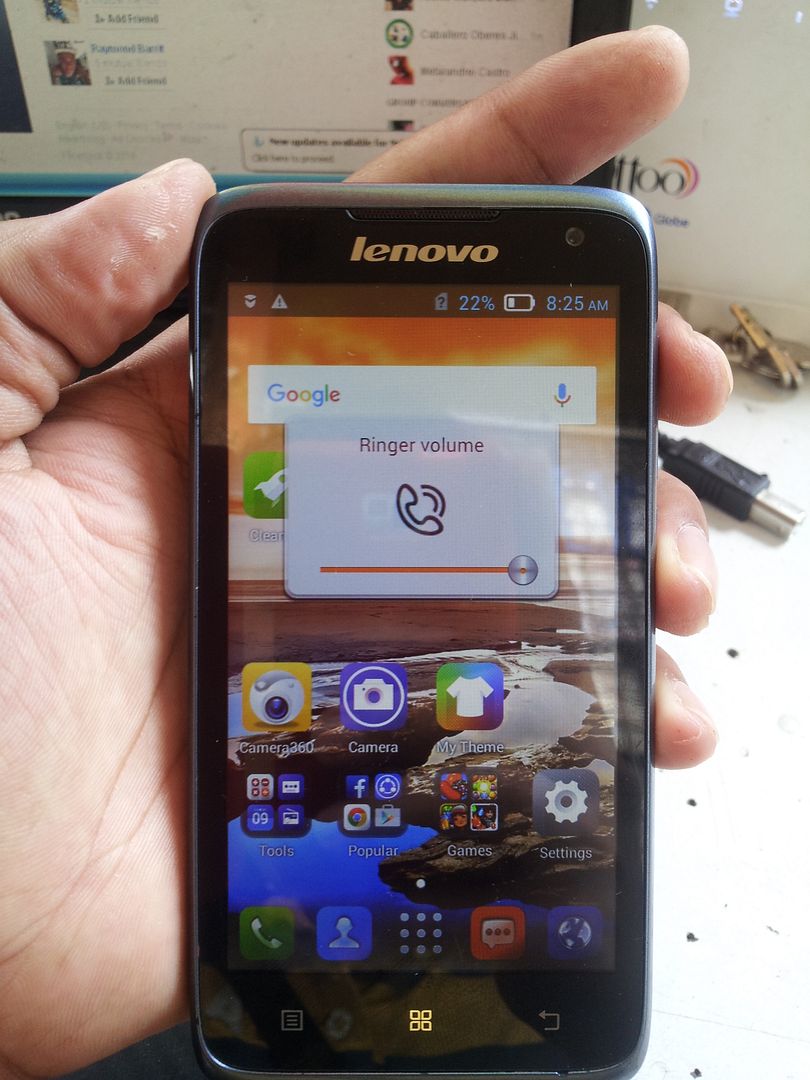

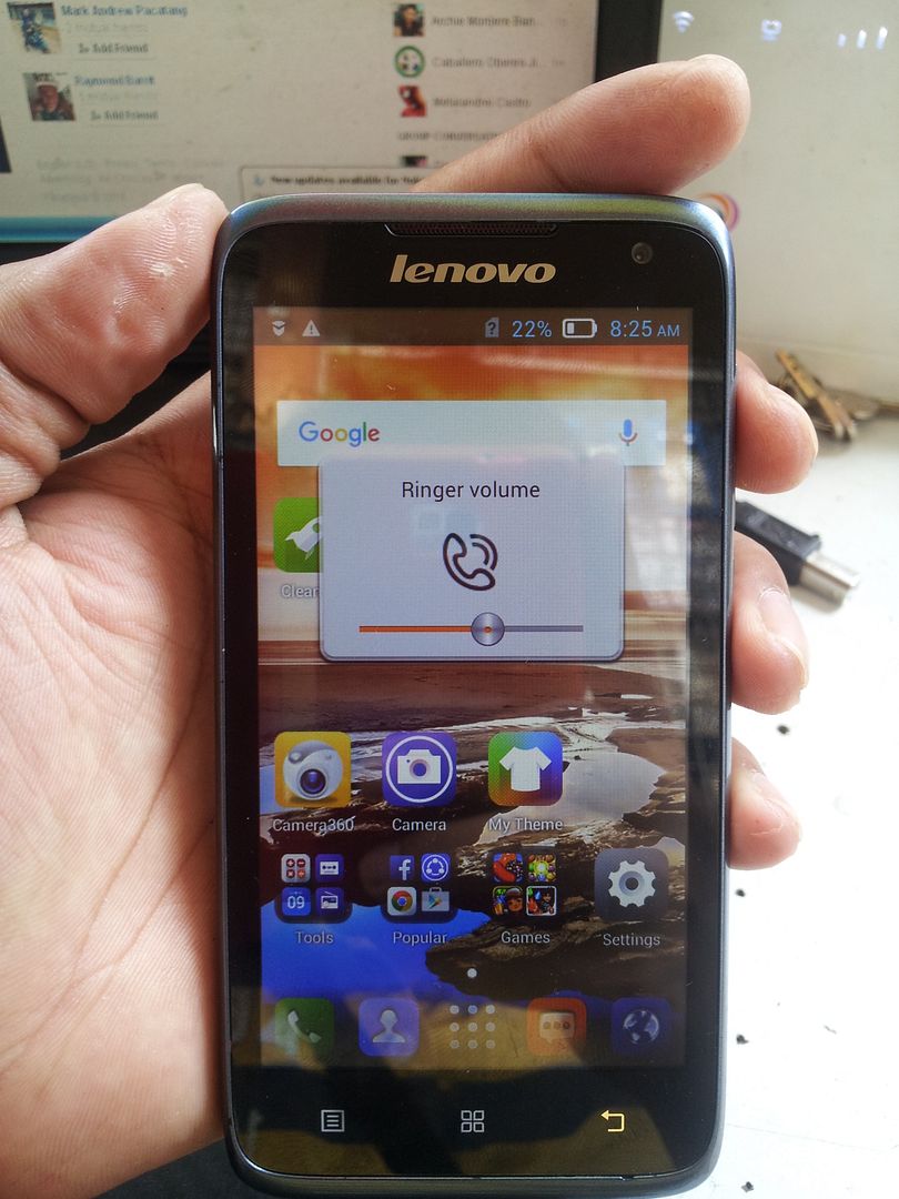

Test ko Volume + at Volume -
[URL=http://s1155.photobucket.com/user/Jr_gsm/media/20000101_092841_zpsfcmcpmtv.jpg.html]
[/URL]
[URL=http://s1155.photobucket.com/user/Jr_gsm/media/20000101_092849_zpstfezrmx7.jpg.html]
[/URL]
[/URL]Test ko Unit ulit after remove ito na
[/URL]Test ko Volume + at Volume -
[/URL][URL=http://s1155.photobucket.com/user/Jr_gsm/media/20000101_092849_zpstfezrmx7.jpg.html]
