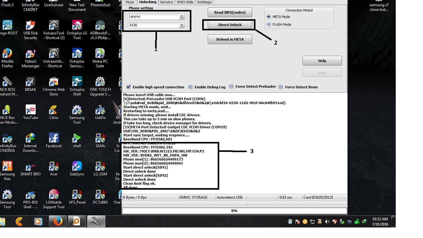

gud pm mga pre. long time no see. share ko lang itong repair ko this time. pero bago ang lahat. happy sunday muna mga sir. sana kumita tayo ng maayos ngayong araw.
PROCEDURE:
-ofcourse. open si nck box android mtkdroid tool.
-go to unlocking tab.
-choose the the correct brand and model.
-then hit direct unlock.
-make the phone off. then follow the procedure. that the software was given.
-then wait lang ng ilang minuto. then boom. pera na yan.
note:
install the cdc driver if needed. kasi hindi yan magtutuloy pag wala kayong driver.
SS.

for reference lang mga idol. walang photo yung yung finish product. walang camera eh. follow lang yung procedure at screen shot. ok na ok yan. tnx for viewing....!
