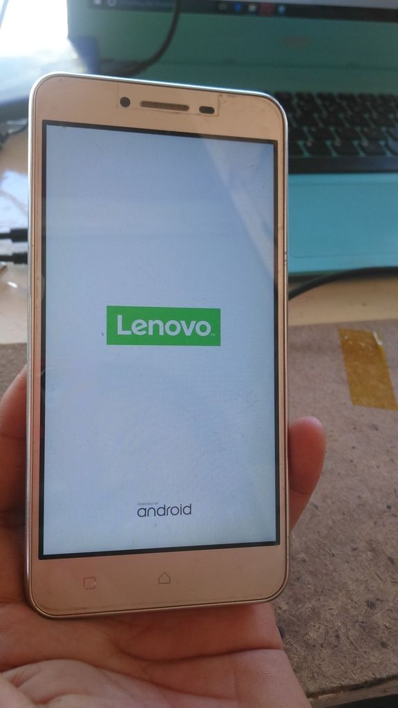

lenovo A6020a40_s027 hang done via cm2
unit status: hang on logo minsan recovery mode lang
firmware link: https://cloud.mail.ru/public/BPTG/2ruvTeN9M
after ma DL ang firmware
open cm2 qualcom module load firmware
tick flash wait for flashing to finish and your done!!!!

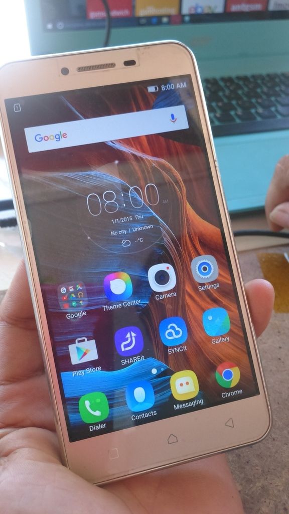

Flashing done!
Done!
Elapsed: 00:06:40
Reconnect Power/Cable!
note: dapat parehas ang build no. sa unit na firmware ang gamitin pag di parehas stillhang on logo...
panu malaman kung ano build no. mo kung maka pasok pa sa recovery mode dun mo makikita ang build no. mo sakin eto ang build no. ko A6020a40_S027
ETO LINK SA MGA FIRMWARE WITH BUILD NO..
https://repairmymobile.in/flash/lenovo-a6020a40-stock-rom/:):):)

Flashing : gpt_main0.bin
Flashing : gpt_backup0.bin
Flash sequence completed!
Records in Chain : 26
Processing records now
Records sequence completed!
Boot settings configured!
Flashing done!
Done!
Elapsed: 00:06:40
