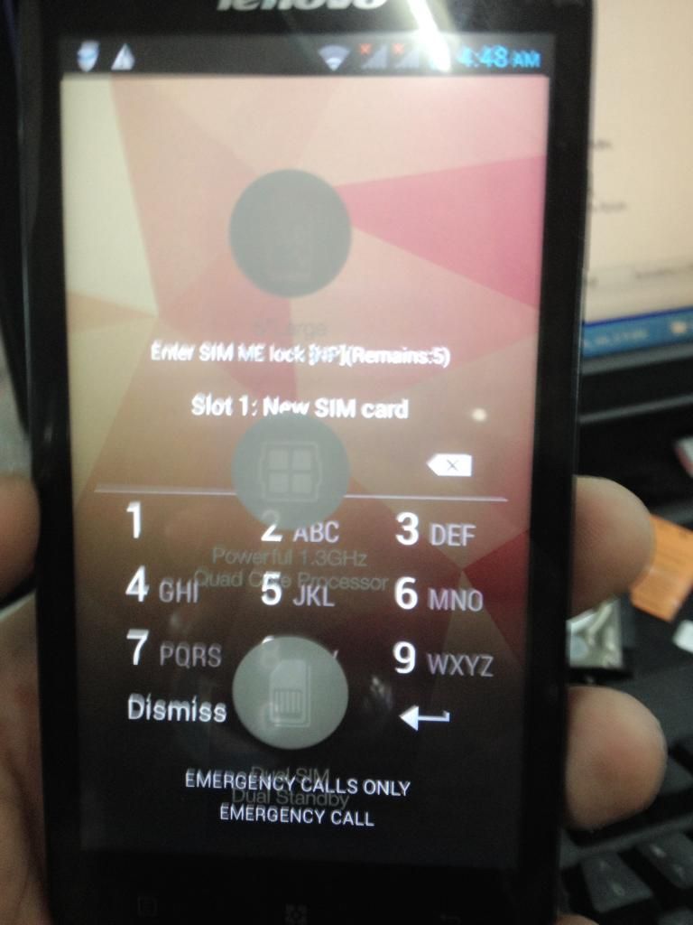

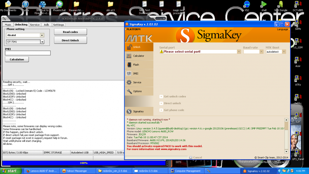

Try sa Sigma need activation to avail Unlock codes/Direct Unlock
Nck Dongle "wala sa Lenovo Tab" try natin sa ibang Brand/modeL
Procedure:
Select AlcateL Tab
Select OT-7041
Hit Read Codes
viola!
Screen shots:
heres proof nahingi ng activation sa aking sigma
ignore lang po ung redsnow napasabay lang while unlocking

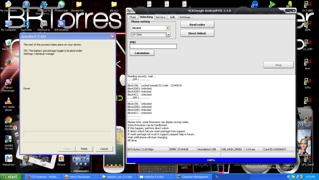

Procedure:
Select AlcateL Tab
Select OT-7041
Hit Read Codes
viola!
Screen shots:
Logs:
Reading security, wait...
......SIM 1...........
Block1(N) : Locked (remain:5) Code : 12345678
Block2(NS): Unlocked
Block3(SP): Unlocked
Block4(C) : Unlocked
......SIM 2...........
Block1(N) : Unlocked
Please note, some firmwares can display wrong codes.
Some firmwares can be hardlocked.
If this happen, perform direct unlock.
If direct unlock fail,use reset package from support.
If reset package not exist in support,request help in forum.
Wait untill phone will start charging.
All done.

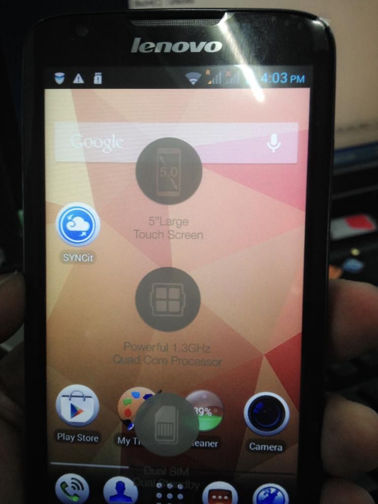

input codes Given by Nck
Pasok!
After input nck codes
