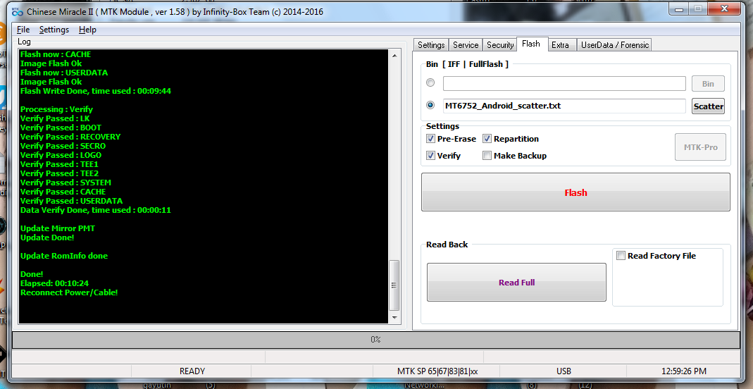

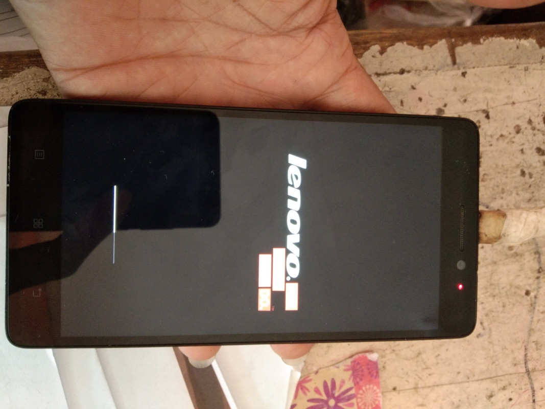

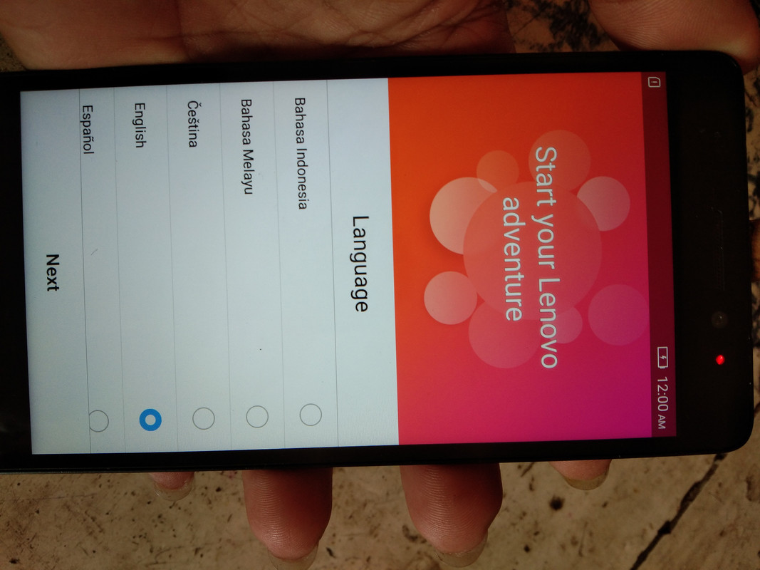

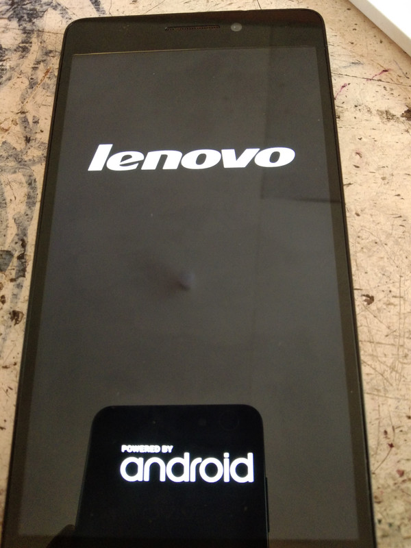

share ko alng po itong gawa ko Lenovo A7000-A Hang Logo galing pang ibang bansa hindi nagawa dun...
Chinese Miracle II (c) 2016
Device Brand : Lenovo
Device Model : A7000-a
Device CPU : MT6752
Device IntName : aio_row
Device Version : 5.0
Device Compile : 5/27/2015 11:43:01 PM
Device Project : A7000-a_USR_S137_1505280741_MP6.V3_LENOVO6752_BMAIN_ROW
Device ExtInfo : Lenovo A7000-a
Scatter Load Ok , BaseBand : MT6752 , Project : aio_row , Storage : EMMC
Files found : 11 , Set to Flash : 10
Created by Infinity-Box (c) Chinese Miracle II (c) 2016
Device CPU : MT6752
Ready to Flash!
Operation : Flash [ v1.58 ]
======= Flash
Wait for phone...
Phone found! [ 32 ]
Sync...
Inital Boot Ok!
BB_CPU_PID : 6752
BB_CPU_NME : [MediaTek] MT6732|MT6752_S00
BB_CPU_EXT : 0xCA01 , 0x8A00 , 0x0000
Processing BROM stage
Settings for BROM configured!
SecCfgVal : 0x00000000
BromVer : 0x0005
BLVersion : 0x00FE
PreLoader : NOT Active [ Erased ]
Processing DA stage
DA Select done, will use MTK_AllInOne_DA_v3.3001.00.00
Sending and initialize DA ...
Running DA ver.4.2 on BBID : 0x8F
NAND Flash : NOT INSTALLED
eMMC Flash : 150100523758314D42098972C87452EF
Initialize Memory ...
DRAM configured from ScatFW!
DRAM initialize passed!
DRAM size : 0x80000000
DAgent sent , init HW now
eMMC FlashIC initialized
[eMMC] : FLASH_VEN : 0x15 , OEM : 0100
[eMMC] : FLASH_INF : [SAMSUNG] , BM1X7
[eMMC] : FLASH_CID : 150100523758314D42098972C87452EF
[eMMC] : FLASH_BRT : 0x00400000 , 0x00400000 , 0x00080000
[eMMC] : FLASH_LEN : 0x00000001D2000000
[eMMC] : FLASH_UCP : 7456 MiB [eMMC 8 GiB]
DEV RID : 0xE76B262BE4FBDC25135DE4BBCBE49FC6
INT RAM : 0x00020000
EXT RAM : 0x80000000 [2 GiB]
BOOT TYPE : EMMC_FLASH_BOOT
SOC VERIFY : C1
Boot Ok!
ScatCFG : BaseBand : MT6752 , Project : aio_row , Storage : EMMC
Setting : Flash Pre-Erase (Safe) : Enabled
Setting : AFF verify : Enabled
Setting : HW verify : Enabled
Switching to HSUSB
HSUSB Init Ok
BL : Check HW compatibility
BL : BBID supported by BootLoader!
BL : Check eMMC compatibility
BL : eMMC supported by BootLoader!
BL : BatteryLevel : 3588 mV
BL : BatteryLevel Ok
BL : Flash Pre-Erase
Total blocks to Erase : 2
Erase : 0x0000000001D00000-0x0000000006320000
Erase : 0x0000000008120000-0x00000001C8E60000
Flash Pre-Erase Done, time used : 00:00:05
SecCfg Passed , 1799
BMT remark not need. Will skip
Sending Preloader ...
Use : preloader_aio_row.bin
Preloader Sent , Init passed
PartCount : 0015
Update PMT by user request
Repartition Done!
Use FLN Mode
Processing : Flash Write
Flash now : LK
Image Flash Ok
Flash now : BOOT
Image Flash Ok
Flash now : RECOVERY
Image Flash Ok
Flash now : SECRO
Image Flash Ok
Flash now : LOGO
Image Flash Ok
Flash now : TEE1
Image Flash Ok
Flash now : TEE2
Image Flash Ok
Flash now : SYSTEM
Image Flash Ok
Flash now : CACHE
Image Flash Ok
Flash now : USERDATA
Image Flash Ok
Flash Write Done, time used : 00:09:44
Processing : Verify
Verify Passed : LK
Verify Passed : BOOT
Verify Passed : RECOVERY
Verify Passed : SECRO
Verify Passed : LOGO
Verify Passed : TEE1
Verify Passed : TEE2
Verify Passed : SYSTEM
Verify Passed : CACHE
Verify Passed : USERDATA
Data Verify Done, time used : 00:00:11
Update Mirror PMT
Update Done!
Update RomInfo done
Done!
Elapsed: 00:10:24
Reconnect Power/Cable!
[/QUOTE]
salamat nga pala sa FW ni JIMROD
http://www.mediafire.com/file/hxjo4zji8hpj5x7/MT6752__Lenovo__Lenovo_A7000-a__A7000-a__5.0__A7000-a_USR_S137_1505280741_MP6.V3_LENOVO6752_BMAIN_ROW.rar
