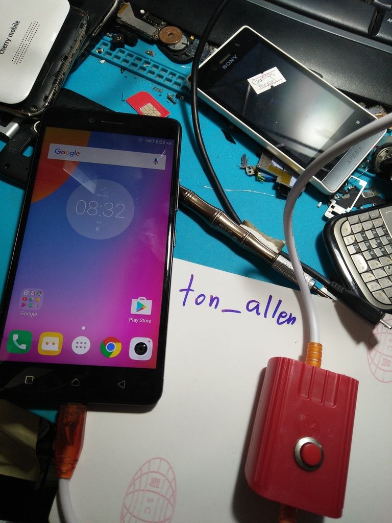

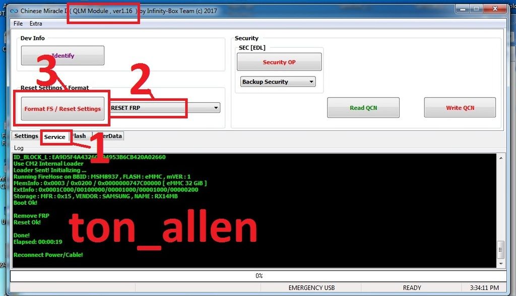

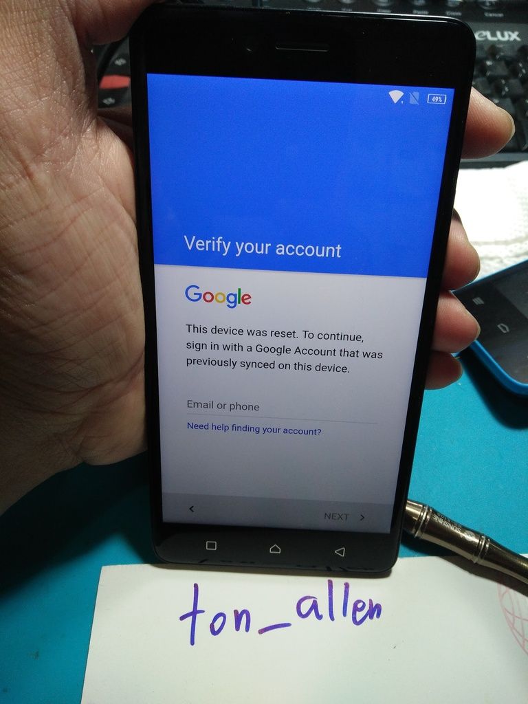

T ton_allen Registered Joined Jun 12, 2014 Messages 35 Reaction score 1 Points 1 Location San Jose, Antique Apr 7, 2018 #1 UNIT: lenovo k53a48 PROBLEM: FRP LOCK ON TOOLS: CM2 DONGLE, EDL CABLE ACTION: 1. Power Off Phone , Remove battery , Insert back 2. PRESS and HOLD BOTH VOLUME KEYS! 3. Insert USB cable. In some cases require use EDL cable or TP to force EDL mode! done
